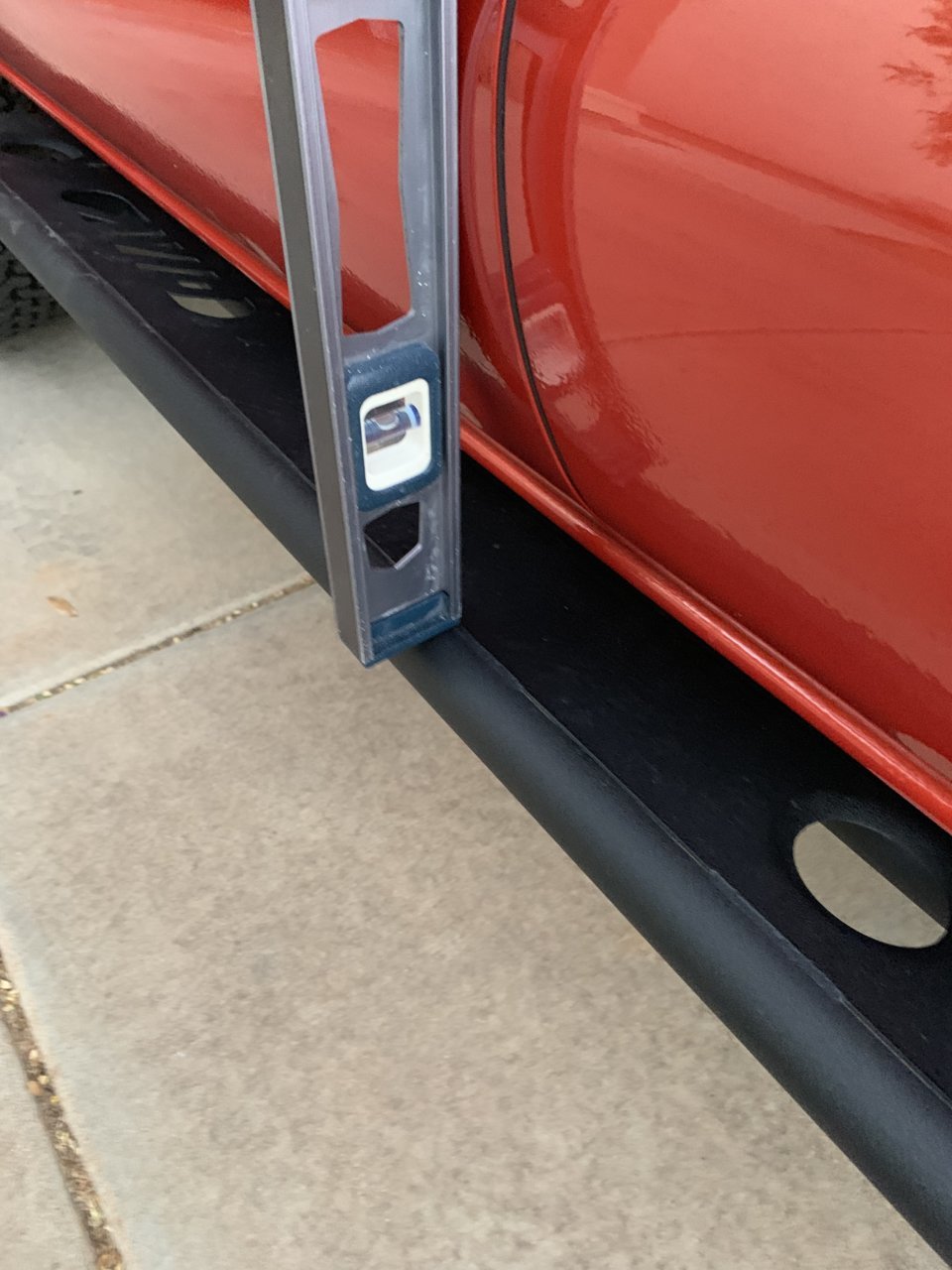

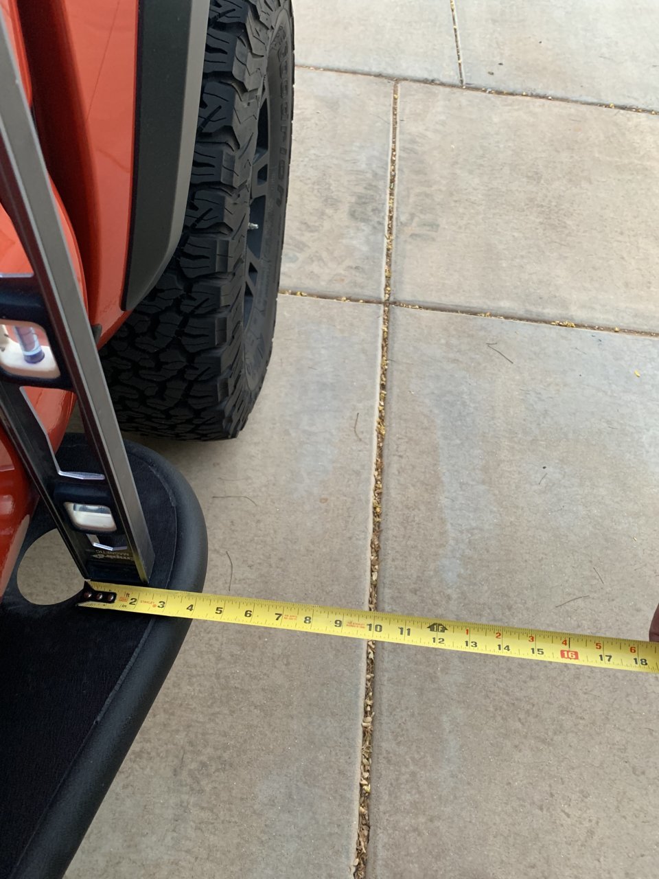

    Kwisak
    Kwisak Well-Known Member
    Sep 16, 2018
    #266471
    1,148
    Jon
    Arizona
    2024 Tundra Limited off-road 2018 Inferno Tacoma Off Road MT
    Pro grill Joying radio with wireless car play Hood decal Bed decal Pro skid Pro wheels 285/70/17 Sliders Blackout emblems Pro exhaust Pro intake Painted engine cover Ditch lights Tint Tacoma letters glove box Off-road wether tech inserts Lock box console Blackvue Orange trim Orange inserts Katzskin Weather tech Bed mat Hilift Tire locks Extra switch Rotopax Fox 2.5 fronts with 700lbs Kings Fox 2.0 rears with resi Icon rxt springs Icon Delta UCAs Meso side markers Meso gashole On order —— Avid bed rack SSO bumper Morimoto headlights and fogs Meso map lights and done light
    This work?
    Underneath doesn’t work as these are bolt on to the frame

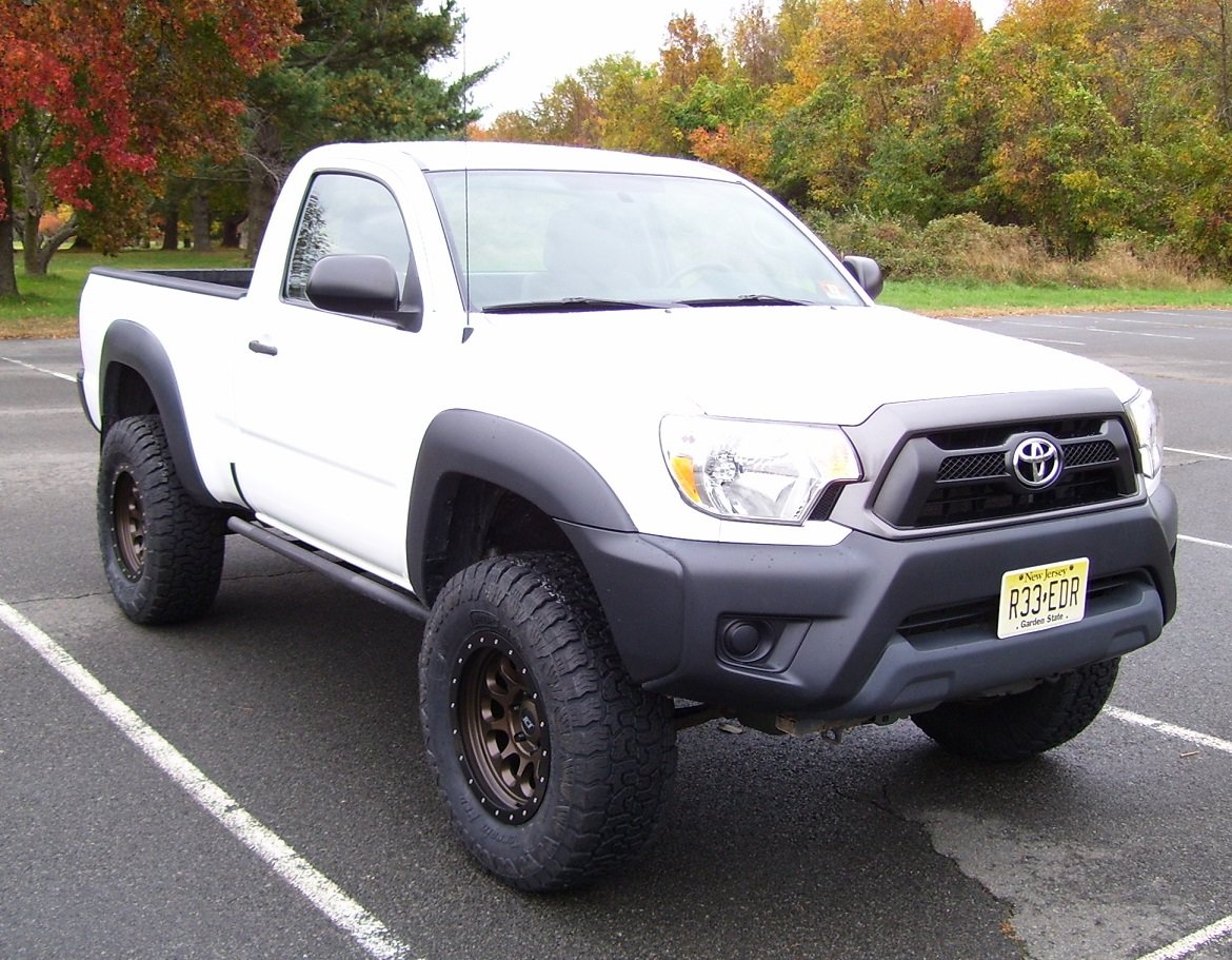

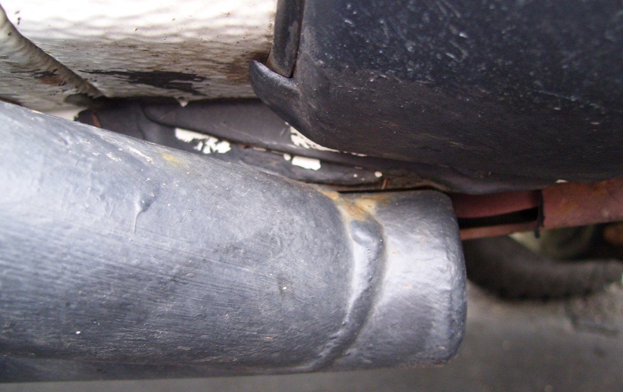

    JL8Jeff
    JL8Jeff Well-Known Member
    Feb 6, 2018
    #243662
    984
    Jeff
    Ewing, NJ
    2013 Tacoma reg cab
    OME 885/nitros, SPC UCA, 305/65/17, AAL
    Mine are 4" from the lip just below the door to the outside of the slider (no bump out). Mine are weld on and were on the truck when I bought it. There is around 1/8" to 1/2" to the pinch weld. The passenger side is 1/8" and hits the pinch weld on hard bumps, so make sure you don't get it that close. I have a piece of rubber hose wedged in there for now to stop the annoying clunk it makes.
