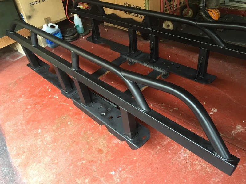

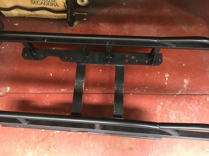

    I just picked up my sliders today. Had to drive across the border and get them from my US PO Box. I bought from Mobtown Offroad during the Black Friday sale. I spent all day prepping and painting. I have a few more coats to do tomorrow. Hopefully I can let them bake and dry in my garage and then get them mounted up soon. I'm excited to see how they will look on my truck.
    I wire wheeled them, sanded them, rubbed them with a green scotch pad, I then cleaned with acetone and then hit them with two coats of self etching primer. I'm painting them with "Rocker Gaurd" which is a rubberized paint.
    Painted and mounted pics soon!

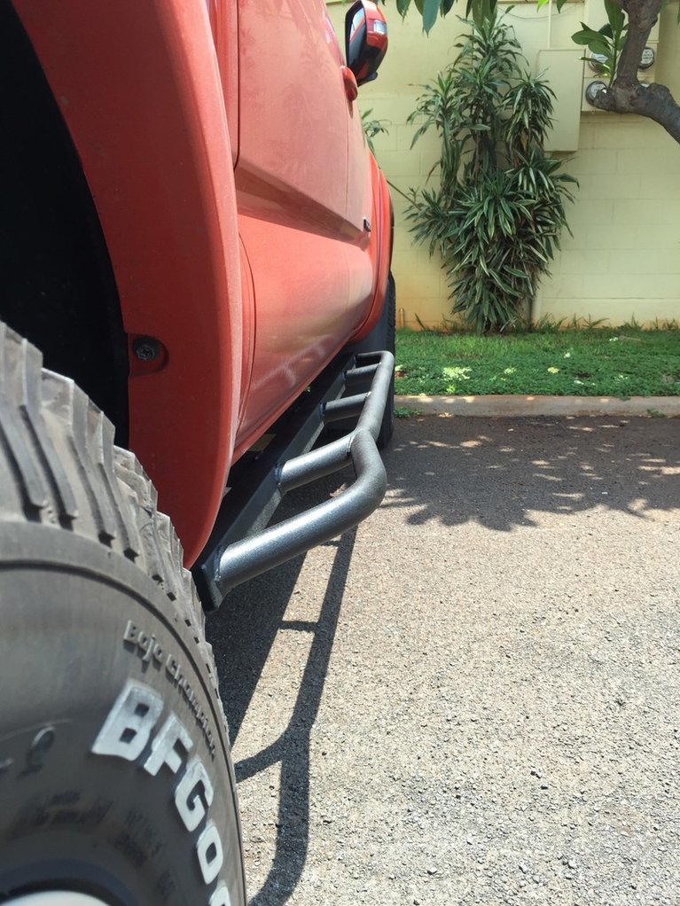

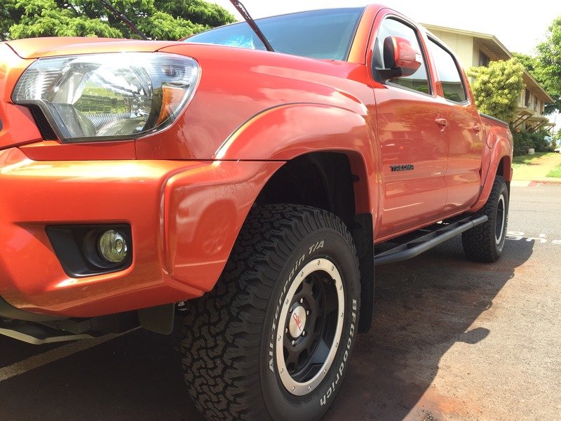

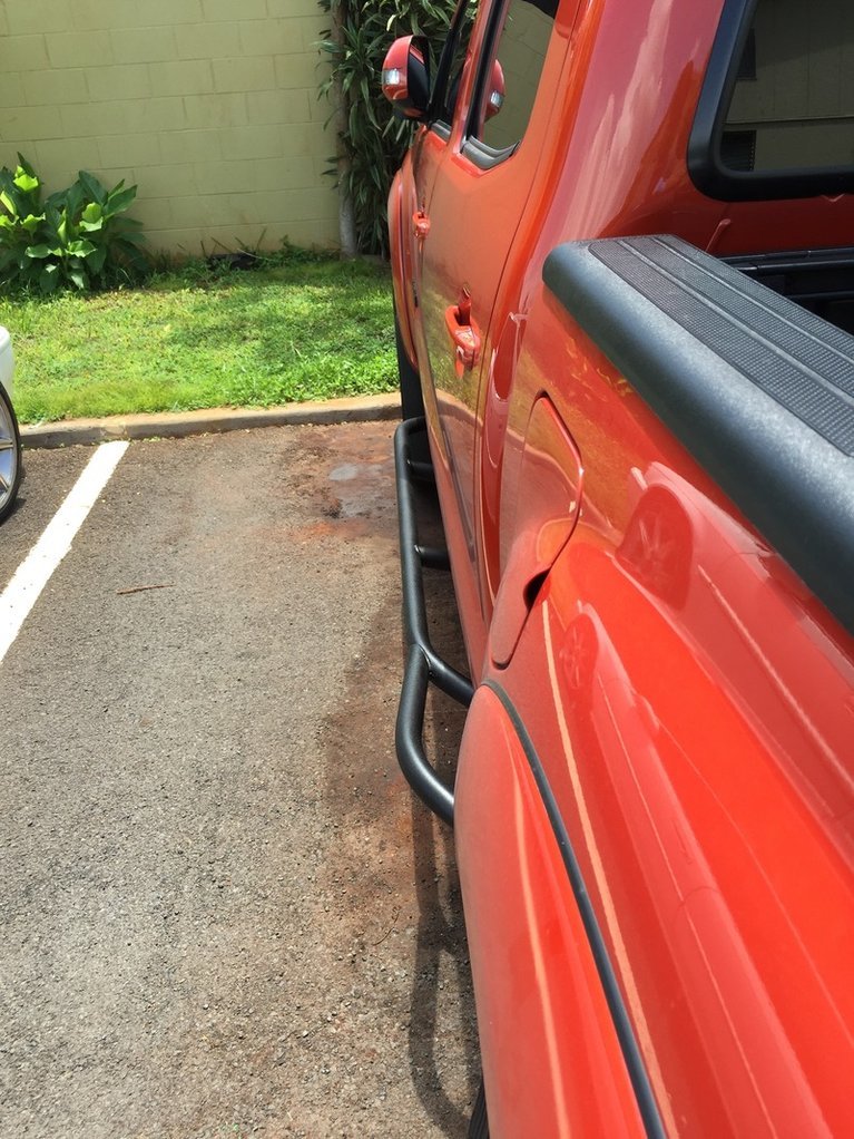

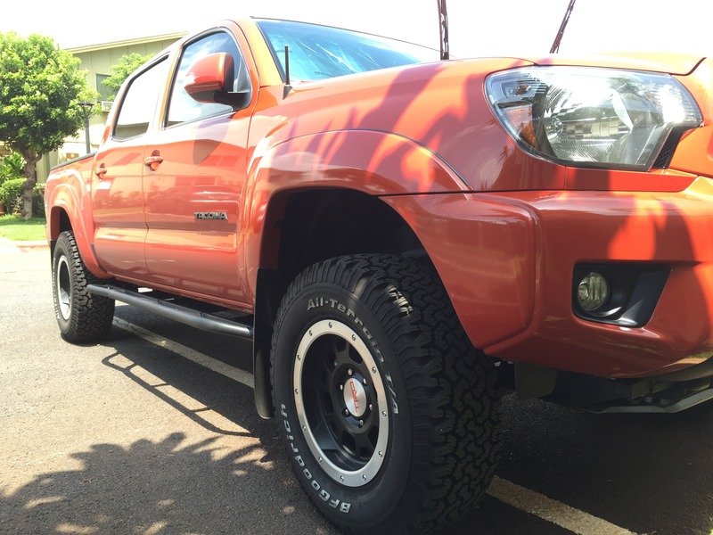

    SOS Offroad Concepts. Bolt-On w/kick out.
