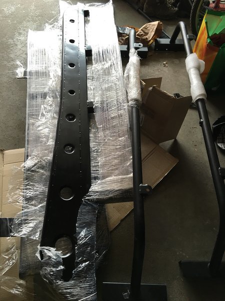

    image.jpg Finally got my sliders in, turned out to be well worth the wait. Ordered the Allpro HD but they made the APEX and sent those instead. The place I ordered from (Tacoma town in cochrane) said it's a free upgrade since they didn't want to keep me waiting for another order :yay:
    I originally wanted the APEX but couldn't justify the extra $300 since both do the job for me. I'll post more pictures of the progress and finished product later.

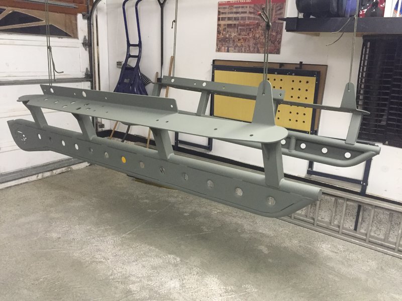

    Paint question. I started by using thinner in a spray bottle and microfiber cloths to clean the sliders. After wiping them down thoroughly I sanded them with 220 grit sand paper. Then thinner and wipe down again and again until clean. Used an air duster before first coat of primer. Here are the materials I'm using.
    I did 2 coats of primer using 3 cans with a day between first and second coat.
    Question is..After letting the second coat dry for 2 hours, I was able to scratch off the primer with my finger nail. Is that normal? I've read that this rustoleum primer should bond well. Any input is appreciated.

    I wanna say the cure time on a self etching primer is way longer than 2 hours, maybe up to 24 hours. I'd check the back of the can. As nice as those are, I'd consider powder coating them.

    Back of the can says half an hour under ideal conditions. I waited a day after first coat and was able to scratch that off. I'm just not sure now if I should go ahead with the bed liner tomorrow or sand and start over. I considered powder coating but chose this route for the convenient touch up when needed.

    Primer is not a top coat so it is usually soft. You are doing everything correctly, so I say top coat it and you will begins to go.
