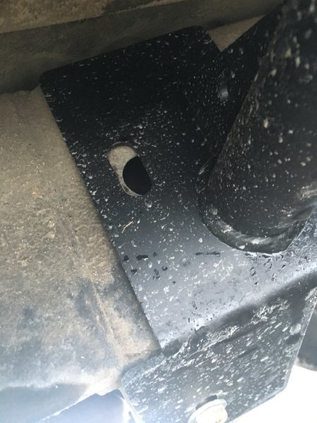

    Gonna post this here as well: but my CBI sliders line up like this on the front mount. Can that be right?

    Use a drill.

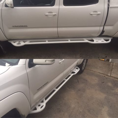

    Chop chop chop weld
    Think I'm gonna get these

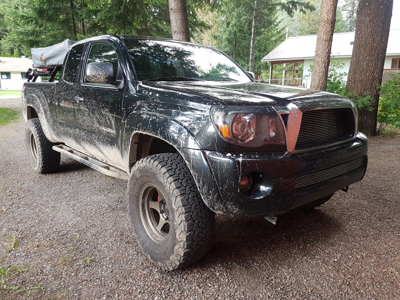

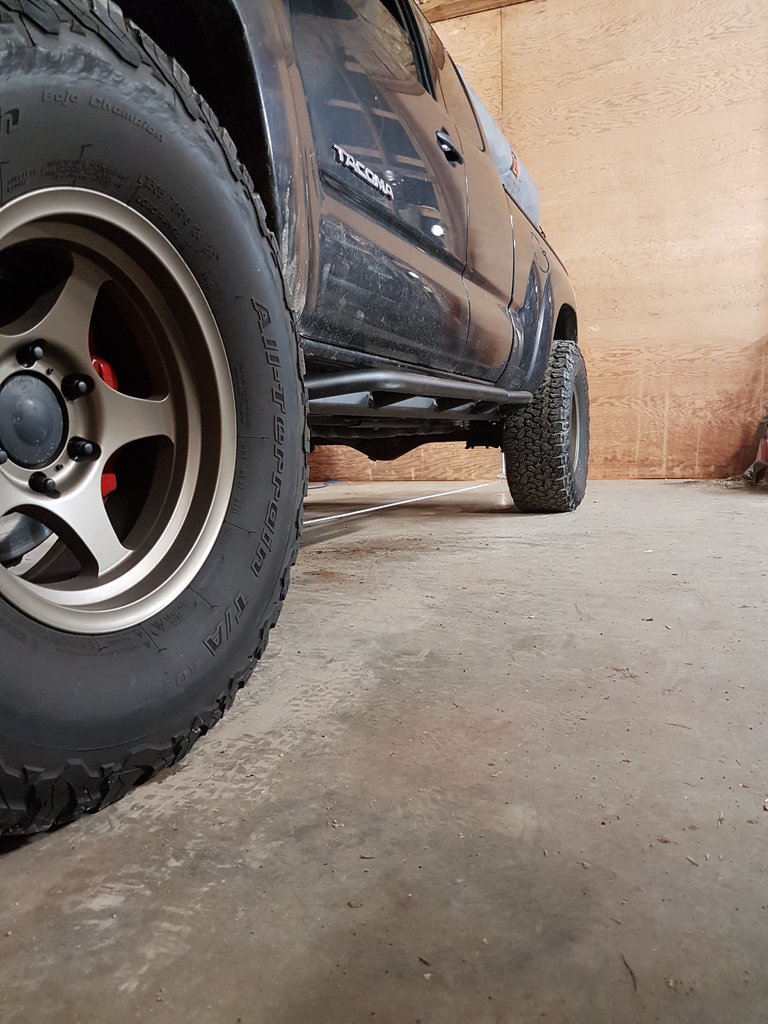

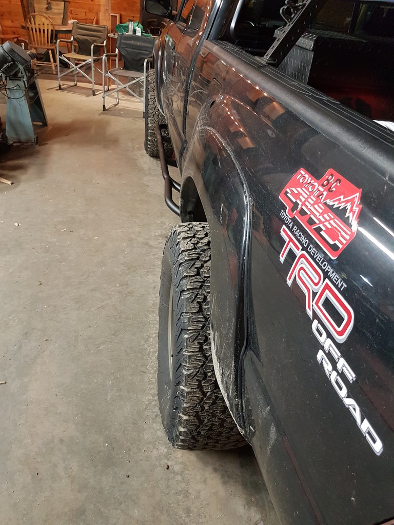

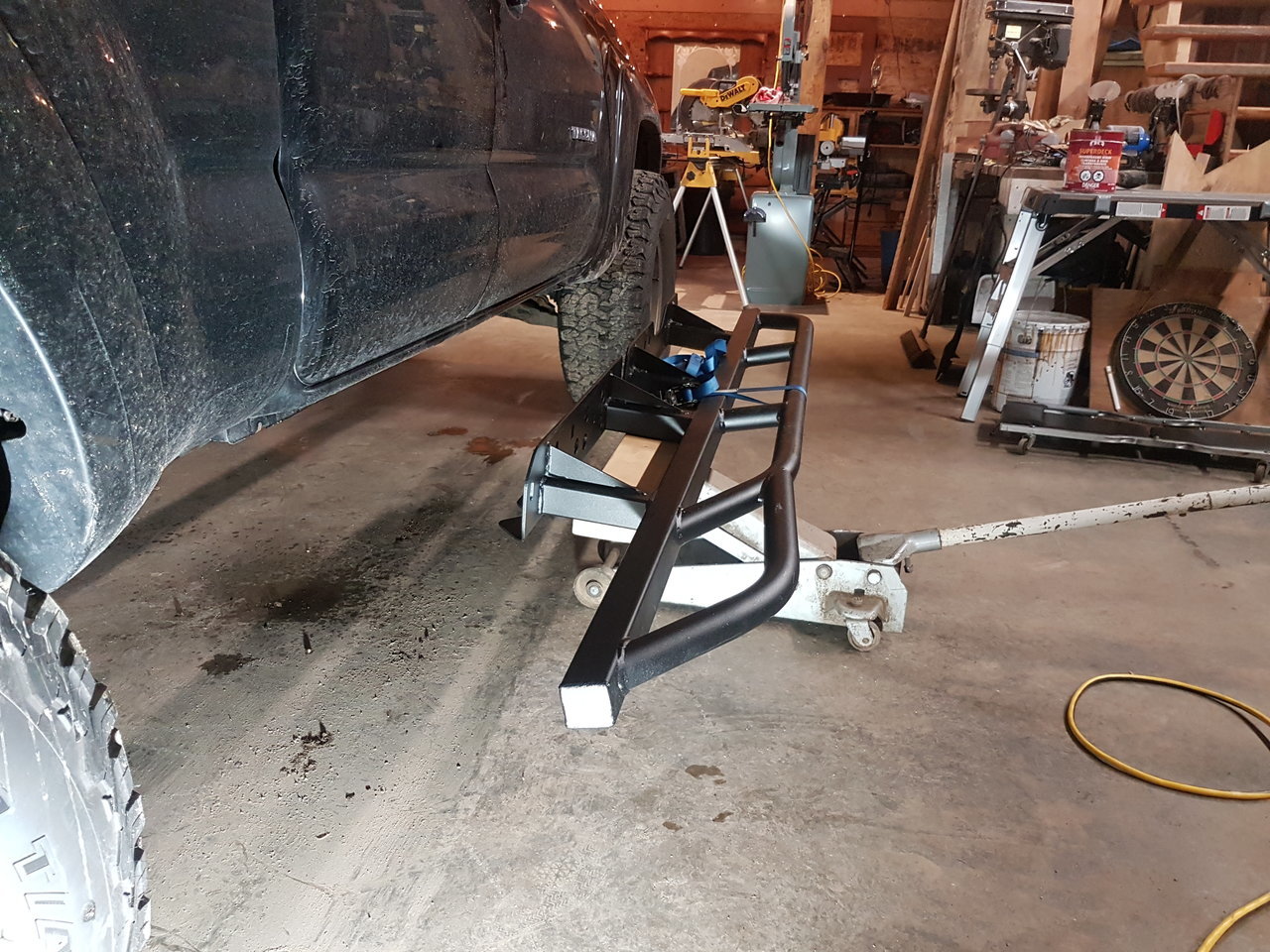

    Thanks Eddy (SOS Concepts) for the sliders, they look great!
    jamie's phone 1558.jpg jamie's phone 1556.jpg jamie's phone 1551.jpg jamie's phone 1704.jpg

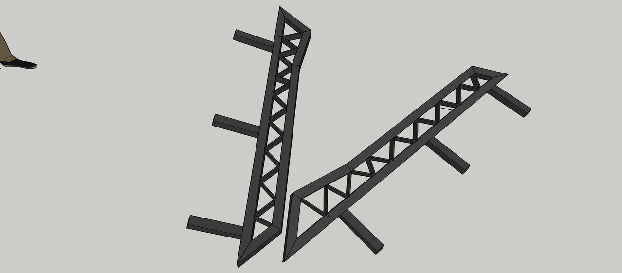

    DCBS. Going to use 2" sq tubing, 11 ga (.125" thickness) Right now I'm figuring on 1/4" plate "webbing". 1/4" mounting plates will weld to the frame for the outriggers to mount to. There will be a gusset from the outrigger to the frame mounting plate. It's on a 22 degree kick.
    As far as projection off the frame, how far should functional sliders stick out past the body line? Preliminarily I measured 15" from the frame to the outside of the tube @ the straight part of the sliders, then the "kick" would project further. Along those lines: does anyone know the height difference from the bottom of the frame to the bottom of the opened doors?

    Why can't you measure it?

    I can, just haven't gotten the level out yet. I will measure it myself before I fab anything but given the amount of people here who have fabbed their own, I figured it worth a shot to see what others have used as a datum.

    Knowing these trucks, the range will be high. :D

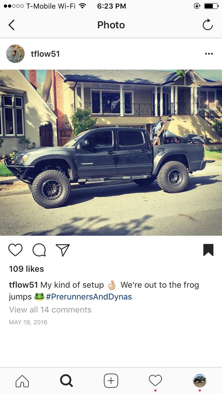

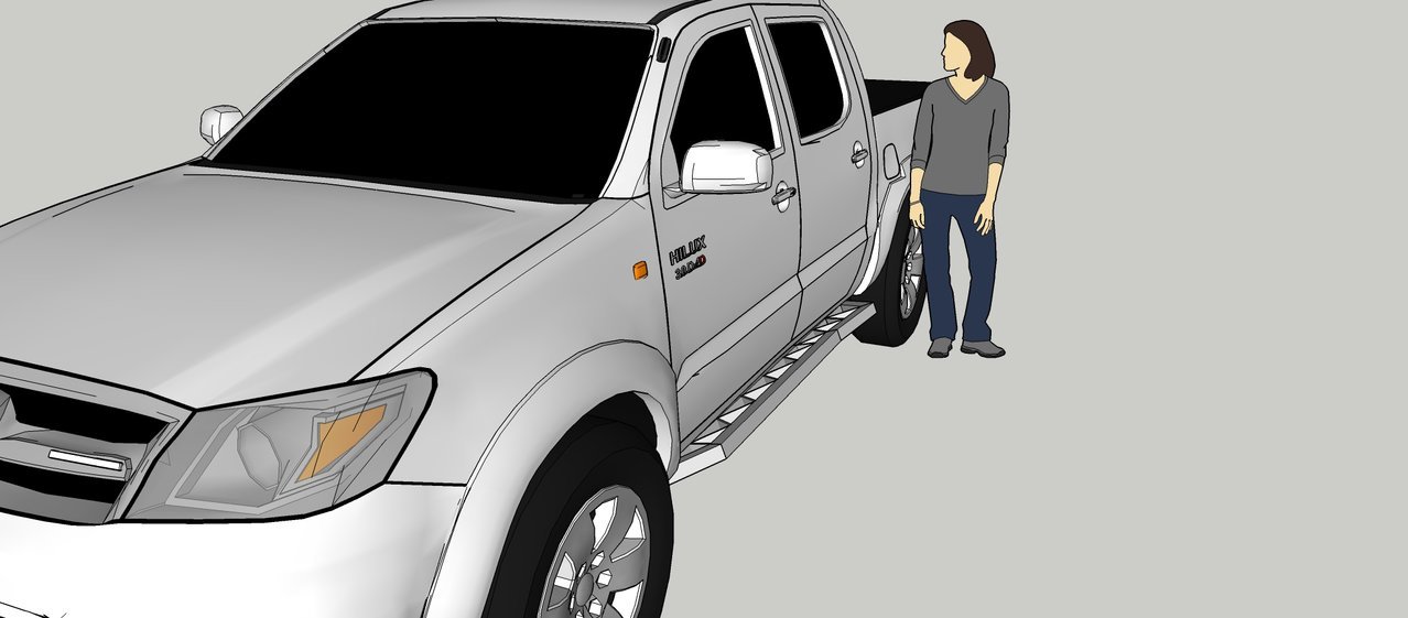

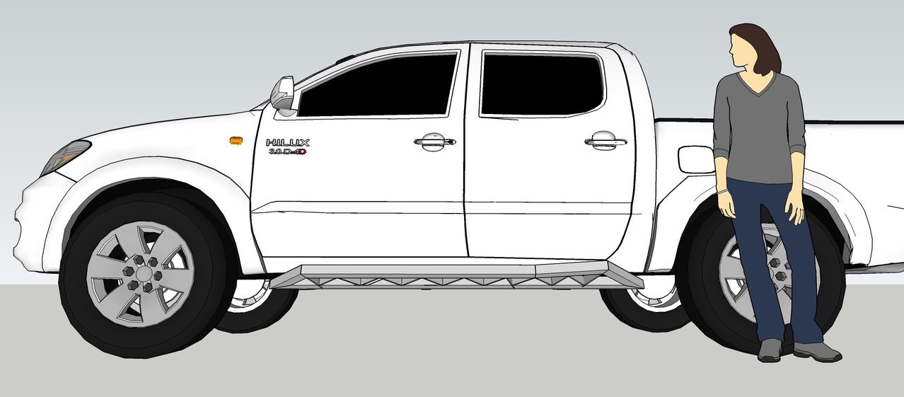

    Who makes these??

    I dont know, but they dont look like actual sliders. There isn't a whole lot of wiggle room between the top of the "slider" tube and the bottom of the cab.
