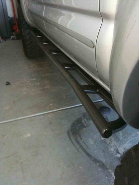

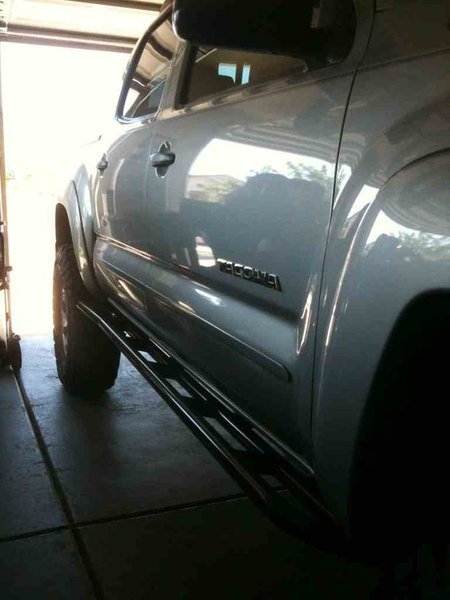

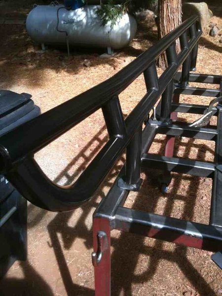

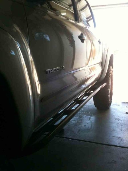

    OME lift with Dakars in the rear, 265/70 R17 BFG KO2. Interior Light Mod, Fog light Mod, Hella Supertones, WeatherTech digital floormats, TRD front tow hook, trimmed front mud flaps, Demello Bolt-on hybrid sliders. Rigid SR-10 hyperspot in the hood scoop, Baja Deisgns Squadron Pros, 30” Baja Designs ONX6+
    Demello hybrid Bolt-on Long bed sliders

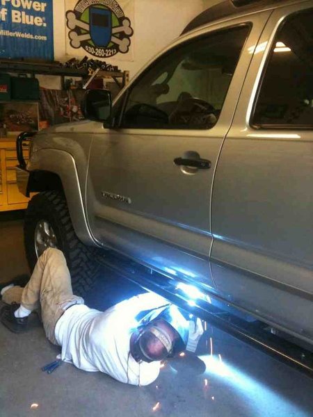

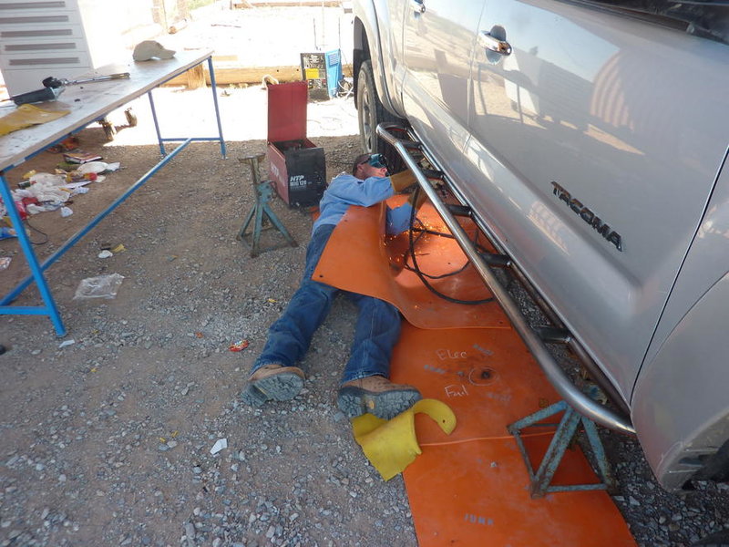

    Joe I have Avid sliders and they are welded to the frame and you know they work haha! MOAB BABY!!!!
  13. Jul 27, 2012 at 2:58 PM
    #133
    mh.meier
    mh.meier Not PB Mike
    Oct 23, 2011
    #65707
    6,726
    The Doctor
    Commiefornia
    Truck Norris Silver Unicornimus Prime
    2008 Tacoma DCLB 4X4 SR5 -Pelfreybilt Steel front single-hoop bumper (12+ conversion) -Baja Designs Squadrons -Baja Designs S8 20” -KM FABRICATION custom 1/4" steel bumper mounts -Warn ZEON Platinum 12,000lb Winch -Pelfreybilt Rear HI-Clearance bumper with swingout -NATO can carrier -Folding Aluminum table -RIGID SRQ reverse lights -Full Pelfreybilt skids -ARB air compressor under the hood -Custom CO2 Setup -KMFAB Custom ext brake line brackets -KMFAB Bedrack -Camping Lab MANSION RTT -ARB Touring 6' Awning -Litra Torch camping light -CTC Bed Cap, color matched -Toyota OEM bedmat -KMFAB bed reinforcement -Pelfreybilt Sliders -BAMF Bed corner tie down brackets -Custom chopped front fenders -OTTRAW switches -King Ext Travel front CO's -King 700# coils -Total Chaos Uni-ball UCA's -Sway-A-Way 2.0 rear ext travel shocks -OME Dakar HD pack with extra AAL -35" Falken MT01s -16" SCS SR8's in Black -Kustom 54 Retrofits -Smoked Tails -Airflow Snorkel -Cobra 29LX CB with PA and the fixins' -KMFAB CB antenna mounts -Pioneer in dash DVD with Nav -Weathertech mats
    Here is a pic of us welding my Avid sliders on. The rear portion of the slider is the square tubing sleeved in the round tubing. EXTRA
    STRONG!!!!!
