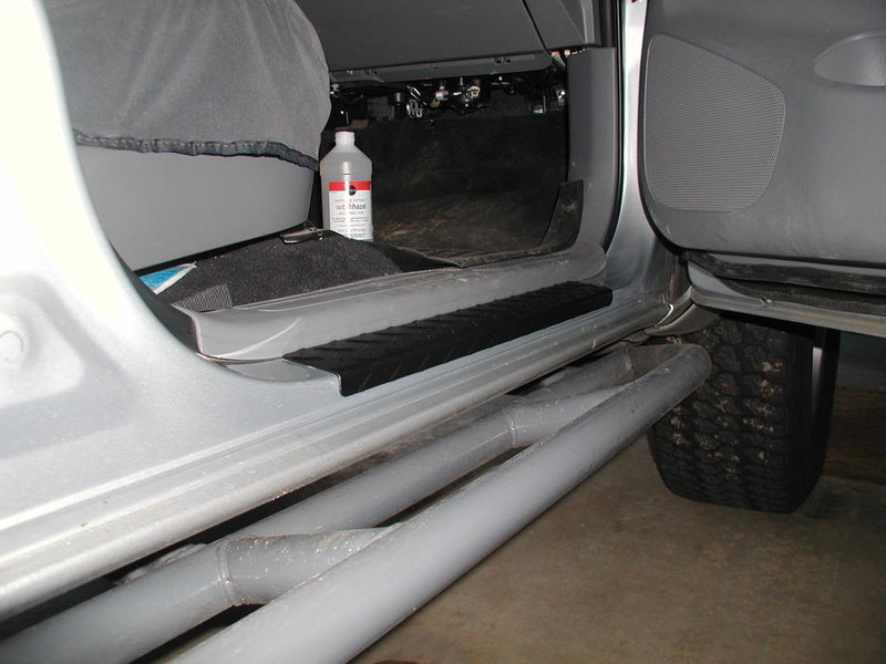

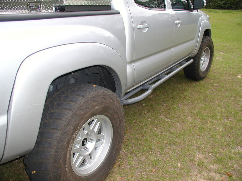

    I've got bolt on's, no probs what so ever. I can take mine off and put them on another Taco in the future. These things are stronger than my truck.
