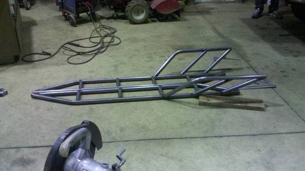

    so i started sliders this weekend and i pretty much already finished them. one needs to be finished welded but the other one is done. so it just needs paint and the legs welded. It was a successful attempt and was alot easier than i thought it would be. The coper/notcher i purchased was by far the best thing i bought for the project!
    ill post some pics soon :D

    Where'd you get the notcher? I need one!

    I got it from harbor freight! Best 30 bucks I have ever spent. It worked like a charm. Soon, in probably a month or less im gonna atempt my rear bumper..

    Awesome man, they look good and damn sure will protect the sides of the body :D I just recently built my own about a month ago and it was a good project to attempt, very happy witht the results! What size tubing did you use? I used 2.5 HREW mig'd and flux cored to the frame. Cant wwait to see em on.

    The coping bit? it should look just like a hole saw w/ an auber , at least thats what i used, technically it is probably more like a drill bit that spirals around and is in varying sizes according to what size tubing you are cutting.

    cant find the coping bit but this is what i used to make mine, along with a grinder which you can also use instead of getting either bit to do it for you it will just take a little more time.

    I just used 1 1/2 tubing to match the front bumper. But yea, the coper I sued pretty much wasjust like that picture, a hole saw and a drill.

    thats all you'll need then, and a good holding vise if you are using a hand drill and not a drill press and then the grinder or worst case scenario a file to get all the lil burs and buggers off the edges. Just be sure to use some type of lubricating liquid along with a metal cutting hole saw or the teeth will get hot and ware down, i broke 2 auber bits cause of that & you willl be good to go!

    Yea cutting fluid iis a must. For all thecopes I onky used 2 holes saws, and they still have life in them.
