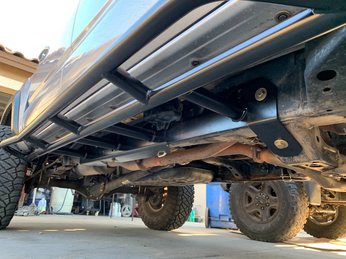

    It looks like they use conventional bolts in some areas, but a u-bolt clamp for the middle section. 00C0C_dPKOP7TxDovz_0CI0t2_1200x900_9c734d82ab36429c37b647fbbd60e75f17a320e1.jpg

    Hm,
    Never purchased anything from DTR or heard anything about them until I googled them after reading your thread. Nothing to say on their craftsmanship or personas apart from the fact that they seem nice/cool/respectful online.
    However, when it comes to the slider itself, that's another story:
    If you want a 'slider' so you can have a place to step to access the bed or work with a rtt then these will certainly do that for you. If you want a slider that can help you overcome a stray rock/boulder that you need to gently bump into on an otherwise easily traveled trail, these sliders will also take care of that for you.
    If you need to do anything 'real' with a slider, i.e. what full blown weld on, or heavily bolted sliders, accomplish then these will not cut it. Hard pulls at an angle from a fellow 'froaders winch to keep you from rolling down a hill? Hell no. Actual difficult wheeling where you will come down hard on a rock, or you need to purposefully engage the slider onto something firm for some reason? Also pass.
    Definitely a unique way to get an easy to install 'slider' onto your truck, but the term is definitely loosely used.
    Disclaimer: I feel confident in sharing this perspective with you as I am a practicing structural engineer with significant experience in steel to steel connections.
    TACOTU3, azshooter40, AZ_TJ and 2 others like this.

    Good to hear, thanks for the insight. Where do you think these sliders would fail that conventional bolt-ons wouldn't?
    I also hope they would have lock nuts or something on those u-bolts to keep them from coming loose from vibration.
    MR E30[QUOTED] likes this.

    Quick answer: There simply aren't enough bolts, nor are there enough bolts at crucial locations, to handle the forces generated by even half a vehicle falling just 6-8". You won't see catastrophic failure in that case although you will likely see deformations, but for $900 you shouldn't see any issues.
    Longer answer: Forces can be magnified depending on load orientation and the path that the load takes before reaching a restraint, more so if the load is retrained in some manner at a location other than a connection before reaching the connection (think of a crowbar. The ground restrains a position of the crowbar, but you ultimately want the curved end to pry up or on something else. This mechanical advantage works in your favor in this situation, though it doesn't work in the crowbars favor. Thankfully crowbars are incredibly strong relative to the forces a single human can generate under normal use.) This is poorly restrained for the real world loads a set of sliders is likely to see. As a result, damage to the slider and/or the truck are much more likely.
    mandog and zdski[QUOTED][OP] like this.

    Great, I see what you're saying. Thankfully I don't see myself wheeling THAT hard with my DCLB. Strongly considering these, especially with the 2-4 week lead time. $900 installed including kickout and powdercoat is a great deal for a light duty slider
