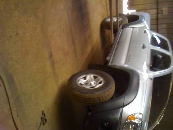

    That's not as "flat" as they seemed in the first pic.
    Do you still have your pinch weld?
