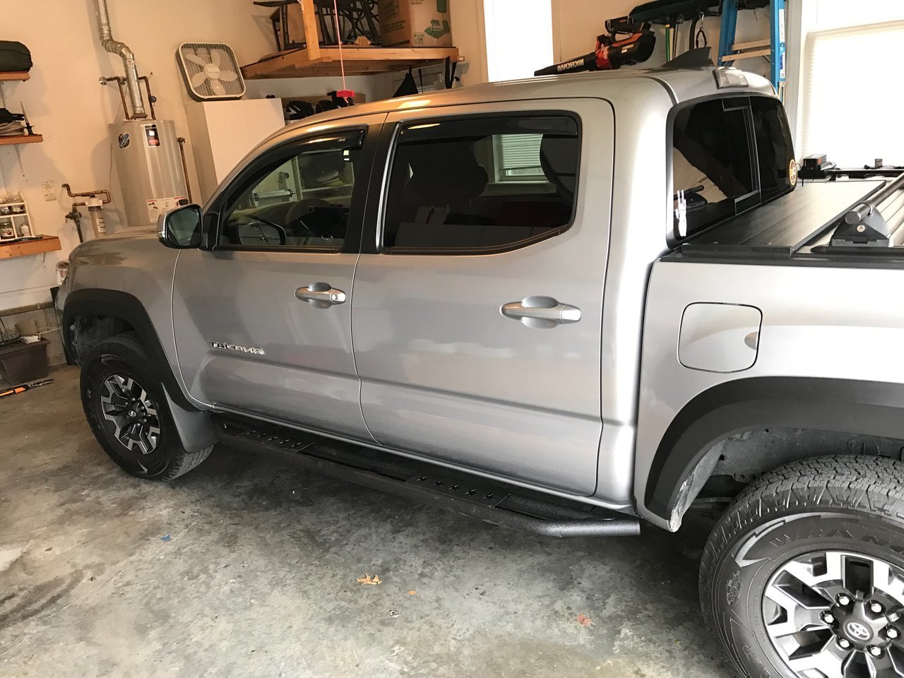

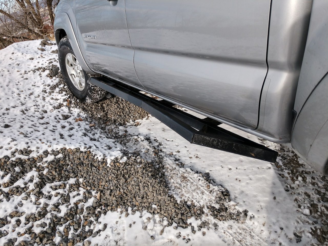

    I have these on my truck and they've been on there for a year now. Have scrapped them a couple of times on rocks but never with any real weight on them and they do save the side of the truck from a lot of debris / splashing. And they have a wide enough platform to actually be useful as a step. Use them all the time primarily to easily load/unload gear from my Prinsu cabrac and helps the wife get in and out really well. I wasn't really sold on the "star" look but it has grown on me and gives a nice custom look. They are heavy, but well built and I see no signs of corrosion or anything after a year of heavy use. I do apply 303 to them ever week or 2 to protect the powdercoating though.
    edit: and you technically don't lose any clearance with these as the lowest part of the step underneath is almost perfectly aligned with where the body height sits FWIW. Yes you are losing clearance from the sides by a couple of inches but no more than you lose underneath the truck if that helps.

    I agree - but do I really need the functionality? It would cost me a lot more to get bolt on sliders.
    Thanks for the pictures, they look better than I expected

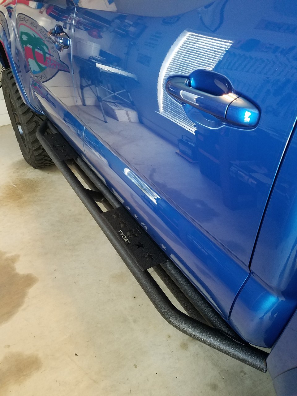

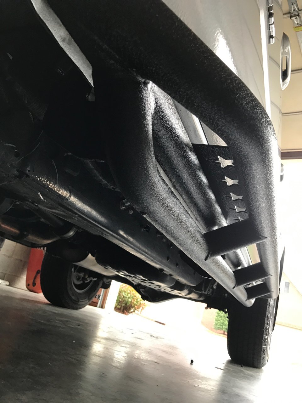

    I also bought the ones you are looking at. Amazon had them on sale 4 weeks back for 238.00 and free shipping.
    Surprisingly very solid and heavy. Installed them by myself using a box to hold one end up. If you do get them here's a tip. Loosely install all bolts and kick the bars towards the truck to "set" them. This way they are as high and as close as they can be before snugglng the bolts down.
    Great quality for the price...
