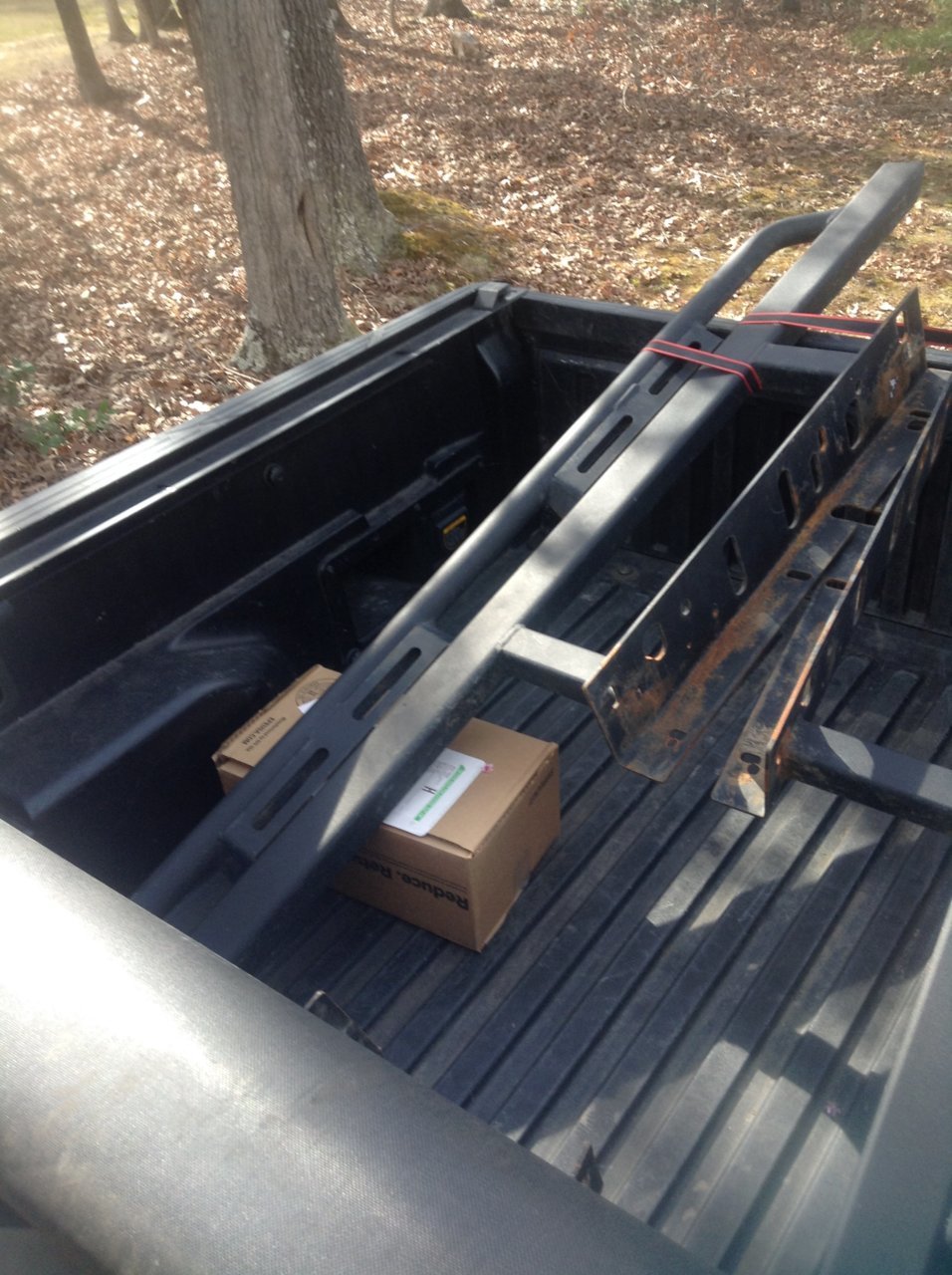

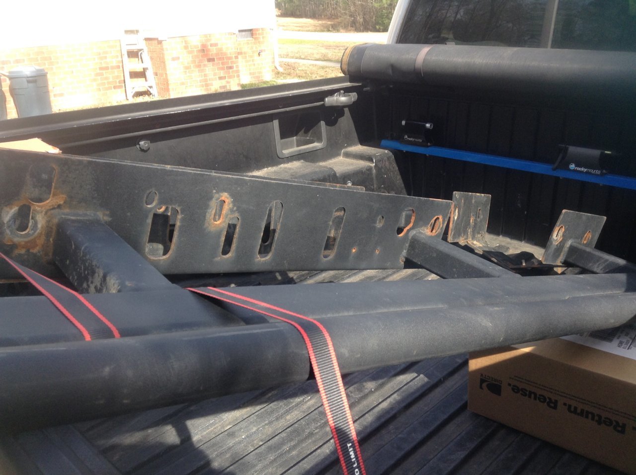

    I found a set of used sliders on Craigslist and picked them up last night. They are in great shape except for a few scratches and surface rust. I'd like to clean them up before I install and wanted some opinions/ideas about which way to go. I could tackle the rust with a wire brush and sandpaper with a medium amount of effort. Has anyone used some kind of over the counter spray that would cover bare metal and old powder coat?
    Or should I just make the investment in new powder coating?
