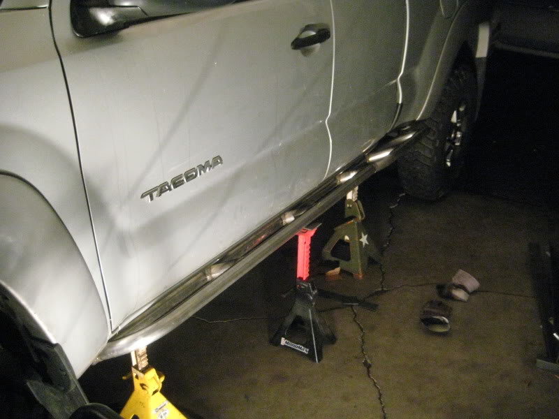

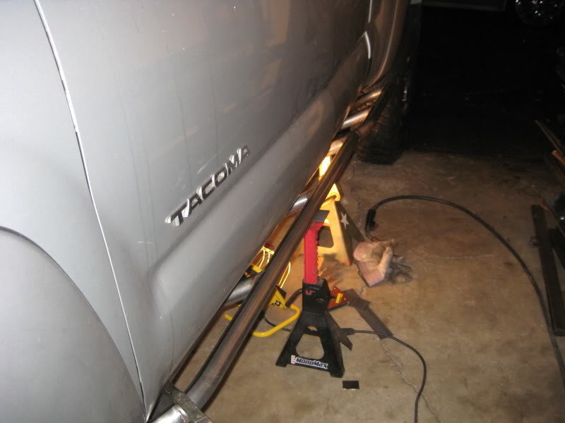

    These angle up nice and tight against the rocker. That was one of my requests when he was making these. I want them nice and tucked with a nice angle to slide off of. Here are a few pics of it on the truck...sorry for the quality, but it was a long day of getting these brackets done.
    Also, Not sure if you guys noticed or not, but look at the pic Beef posted and pay attention to how close he was able to get the legs to the front of the slider. This is a weak point on a lot of off the shelf sliders out there now. He was able to get a support leg RIGHT up on the front (where you come down on rocks most commonly). This is great strength where you need it most! These things are solid!
