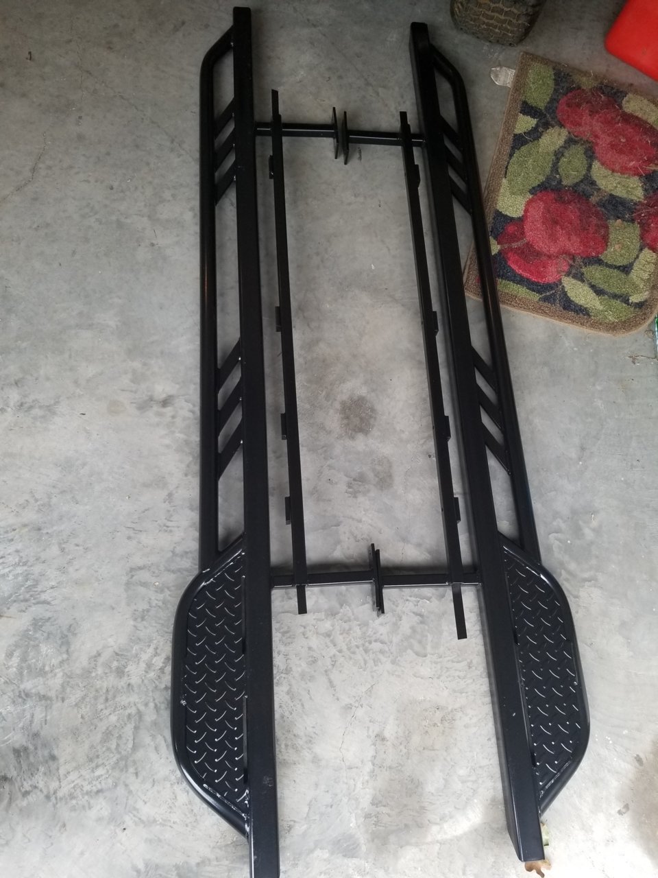

    I have bolt on Rocky Road Outfitters super sliders. It was a pain in the ass to drill. If I had it to do over I would do weld on sliders 20181016_121732.jpg 20181021_161111.jpg 20181021_161111.jpg

    Those don't look like they're meant to go offroad and support the weight of a rig.

    They bolt to the frame with 4 bolts and also bolt to the pinch weld with 4 bolts. I won't be off roading too seriously.

    Those look like (are definitely steps & not sliders) steps not sliders.

    Look up Rocky road Outfitters online

    Curious to see pics of them mounted..never seen or heard of sliders or steps attaching to the pinch weld. Never knew you could to that even.

    Sorry. I didn't take any pics from under. If you look at the sliders the 1x1 to the inside bolts to the pinch weld while the 2x2 is made of hitch steel for the slider
