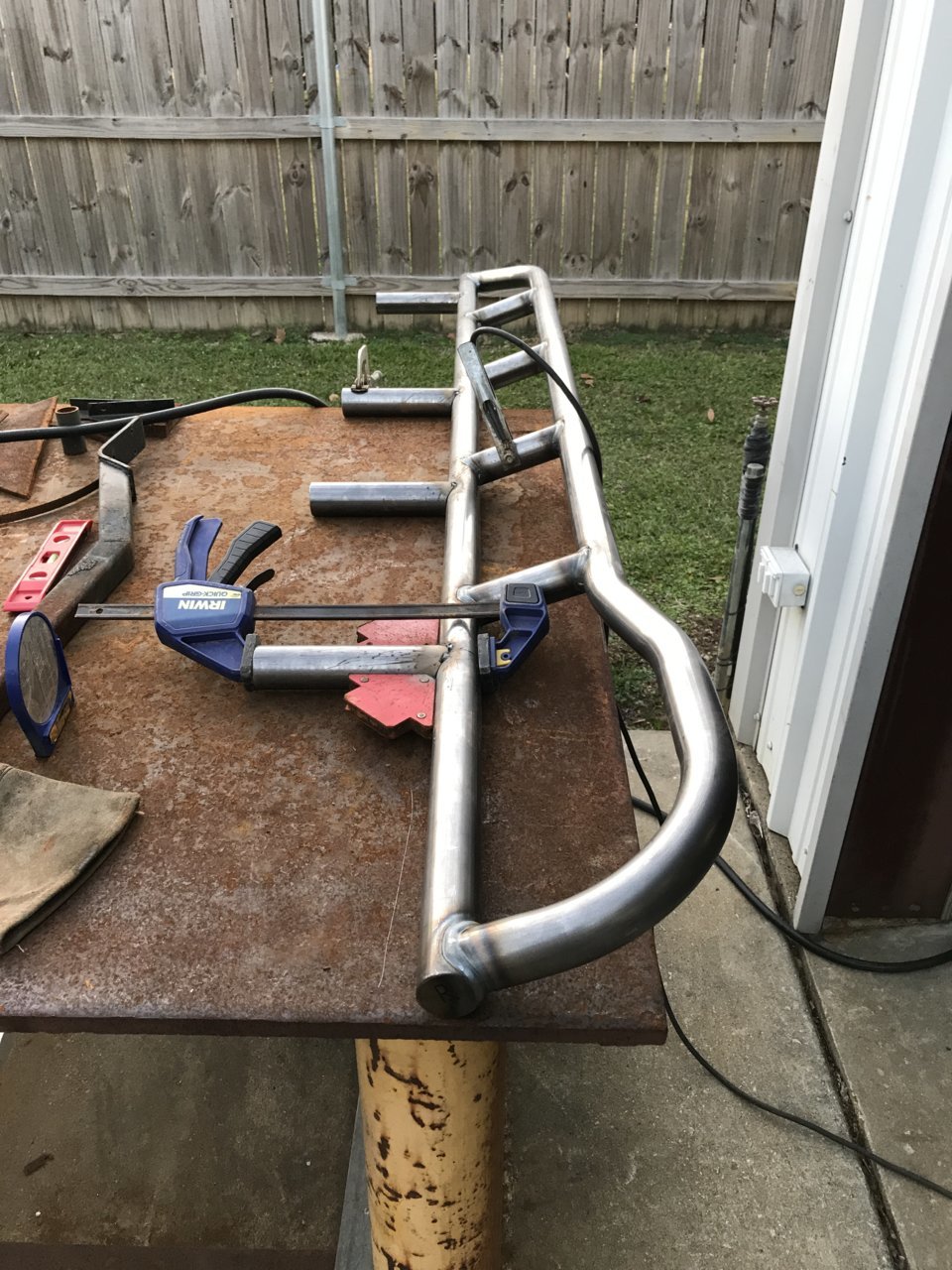

    I went with weld on because I don’t see the point (for me) in ever taking them off.
    I got mine from 4X Innovations. They don’t come ready to weld to the truck though. You have to weld the legs, base plates, and gussets together, then weld them to the truck.

    I’m completely satisfied and don’t regret my decision at all. I like doing most of the work myself when I can. If I had access to a tubing bender, I would’ve built them myself.
    Mobtown, BAMF, and tons of other vendors here make excellent sliders and the bolt on option makes it quick and easy.
    For the price, it made sense for me to just buy these from 4X.
    They’ve been used for their intended purpose and have held up fine.

    What angle did you set the sliders at?
