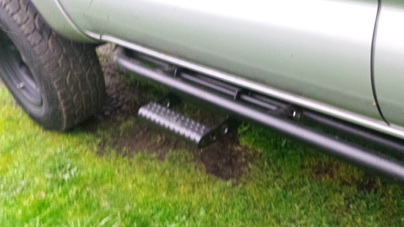

    This helped, thank you.
  20. Mar 25, 2017 at 7:02 PM
    #20
    bluezzy
    bluezzy Love My SuperCharged 07 Sport!
    Feb 3, 2016
    #177007
    1,557
    Monty
    Eugene, Oregon
    it take a bit of doin
