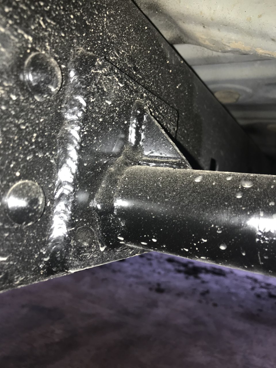

    They seem to be good quality to me.. the reason their price point is so much lower is because theyre a weld together kit. They send you the sliders, legs, gussets and frame plates, and you can get them custom fit to how you want them mounted.
    Heres a pic of them on my truck. Mine are DOM tubing with a round main tube.

    There is some prep work involved to the frame, so you have to account for that time. Then the sliders have to be fitted and clamped, tacked, clamps removed, then full weld can be applied. Special care has to be taken near the gas tank as not to heat that area too much. Then any other brake lines or wire loom on the driver side has to be paid attention to as well. So $250 for a good welder from a tax paying shop is a fair price in my opinion. I suggest painting your sliders prior to having them welded. Make sure you mask the feet off as not to paint those, then also mask off about 3" up the legs. Once welded and the metal has cooled, you can paint the feet.
