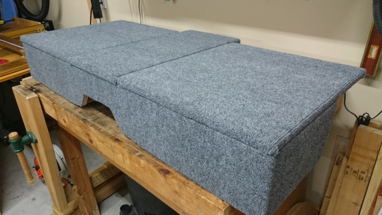

    Ive removed the back seats in my access cab and build a platform to replace it.
    It’s functional but I’d like to make it more functional.
    Searched around. Didn’t find much.
    I’ve seen people mount fridges in the back seat of their truck with sliding platforms. I wanna do something similar but without the fridge.
    Had anyone done this? Or have any decent pictures of it? Looking for inspiration.
    I have an idea using a set of drawer slides similar to how bed drawers are set up just on a lighter scale.

    Current platform

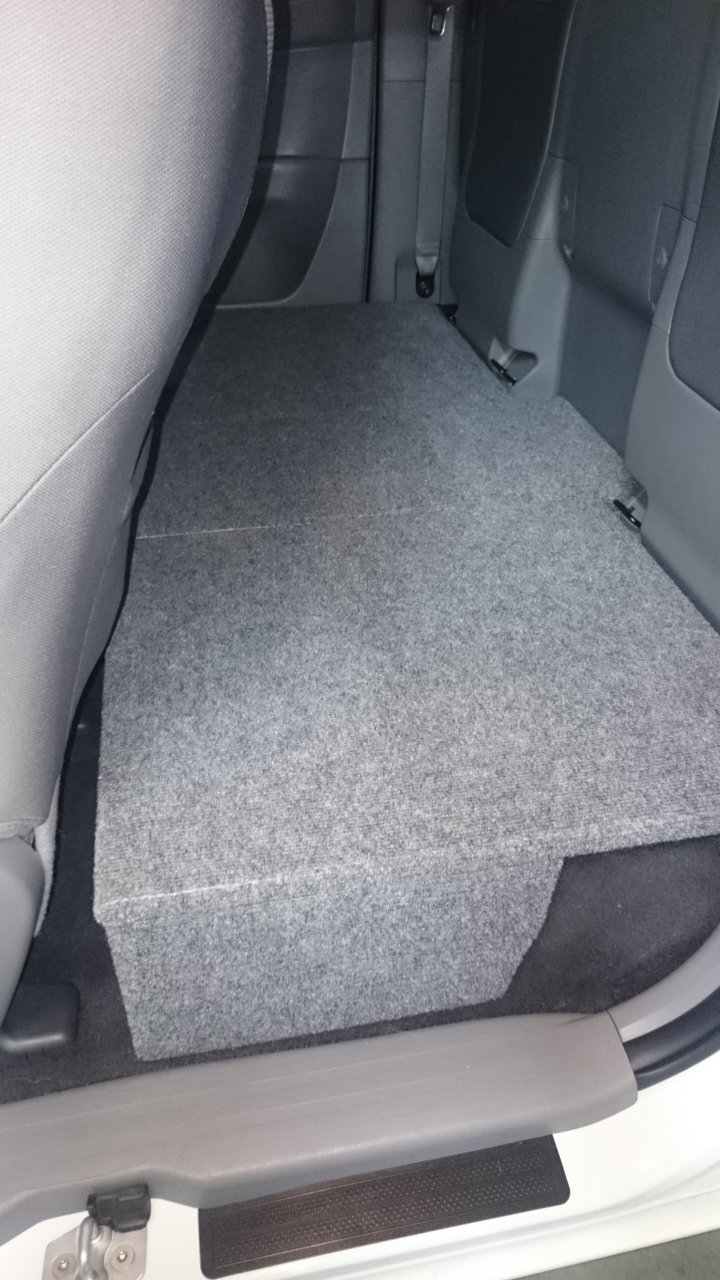

    I made a platform similar to yours but the base encloses the foot well areas and it has three lids that lift up to access storage under the platform. I also removed the console and seat belts to get as flat of an area as possible. I could sleep in there pretty easy and the dog loves riding back there.

    Platform is staying as is and I’ve got everything sorted and situated under it how I like.
    It’s a 2 piece platform so each side comes up separately so it’s super easy to access the cubbies underneath it for stuff.

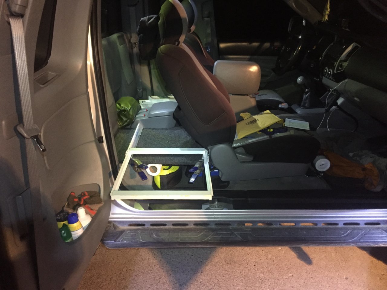

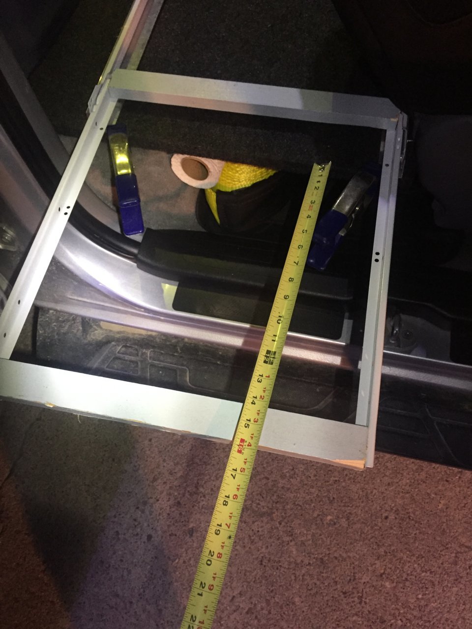

    Mocked this up.
    2 20” drawer slides and 2 sections of L stock.
    The platform is 16”x22.5”. It’ll slide out 16”.
    It’s basically just an extra flat surface. Plus it’s the same size as the gear bag I use for camping so I’m not losing any space.
    I didn’t want to do a full slider just a small section.
