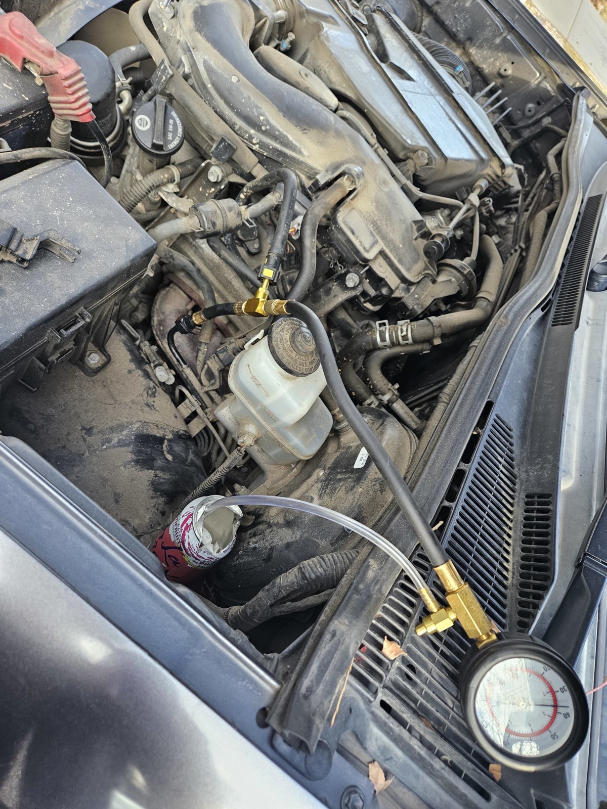

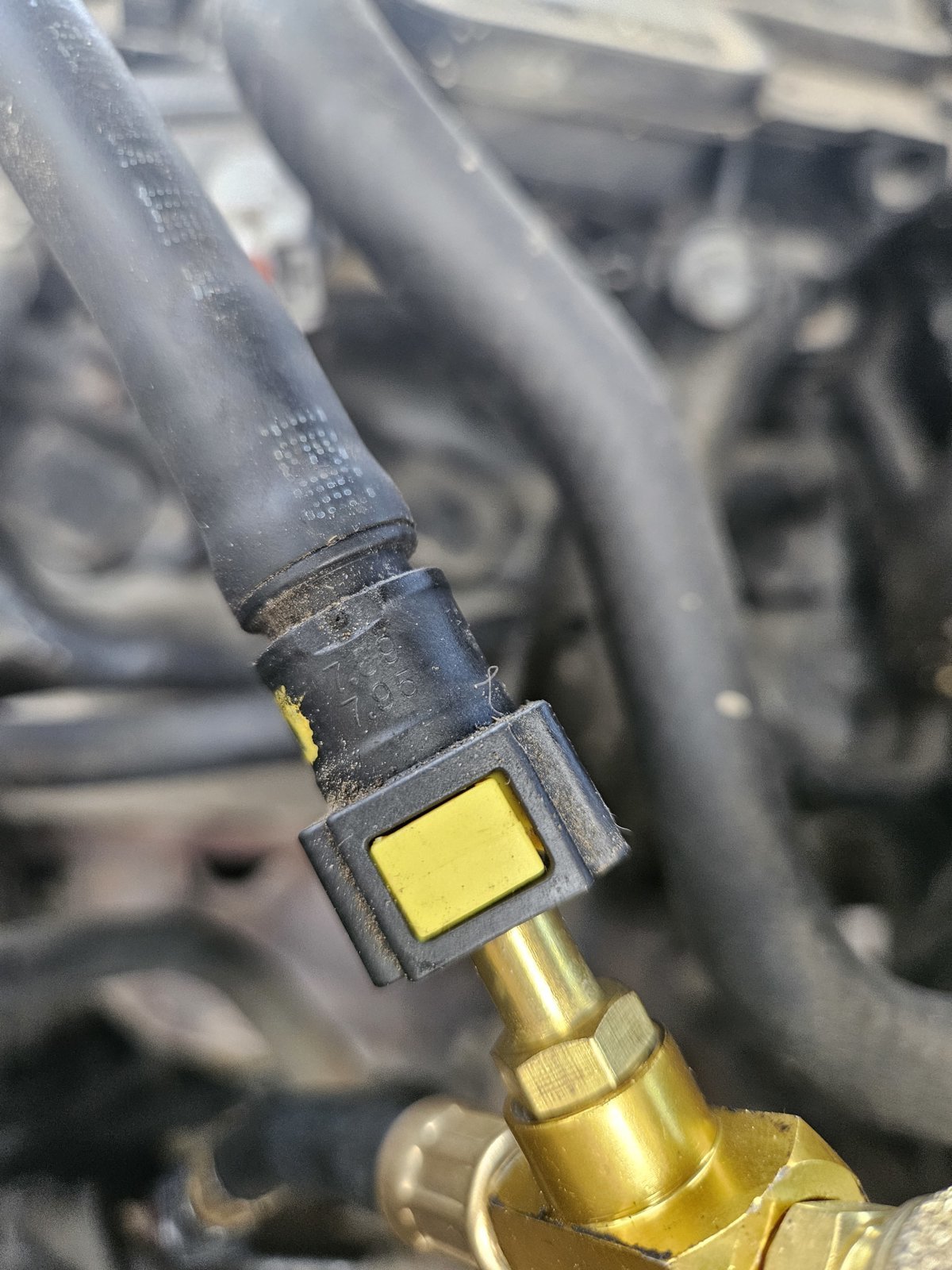

    Got around to checking fuel pressure today and am pretty confident ruling that out.
    Held rock solid between 40-41psi the whole time, cranking, idling, revving. After turning the engine off it held 36 very solid for the 5 mins or so, well above the 21 psi pass/fail.
    One thing to note like I mentioned above. On the first restart after disconnecting the battery, it will fire up and run smooth for about a second or two and then just die. No sputtering or poor running like i thought but just runs and then shuts off almost as if keyed off. Immediate restart has no issues and stays running. Wierd...maybe something with the throttle or idle air control?
    I'm not so majorly concerned that I'm gonna tear the whole truck apart but I'll probably keep digging at this, not willing to chalk it up to 100% old age just yet. It does make me feel better knowing that the fuel pump seems to be fine and that it won't leave me stranded with no fuel pressure one day. Little victories.
