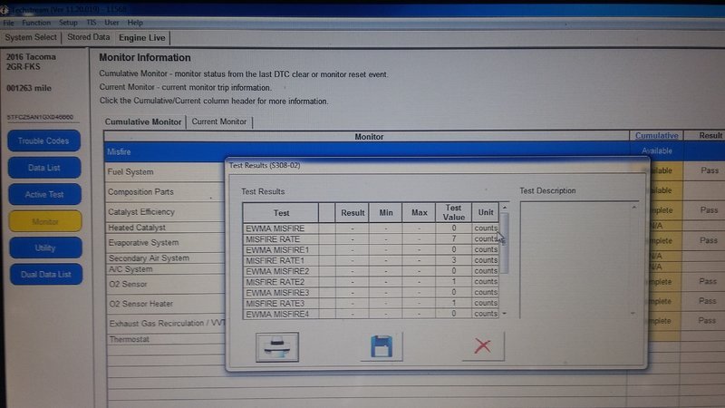

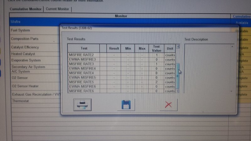

  18. Sep 19, 2016 at 11:14 AM
    #38
    trdgentaco
    trdgentaco Well-Known Member
    Aug 26, 2016
    #195574
    229
    Atlanta, Ga
    2016 tacoma DC OR MT, 89 sassed 4runner
    It's not just misfire feelings for me. Things are getting slightly worse than they are better, at least in this aspect. Still love my truck though. Only 12xx miles
  19. Sep 19, 2016 at 1:19 PM
    #39
    Kilokato
    Kilokato Go Vols!
    Nov 24, 2008
    #10996
    830
    George
    East Tennessee
    2016 SR5 Access Cab V6 Auto 4wd
    Limited wheels, extra rope hooks in bed.
    You are a step ahead of me...Not sure of the print out other than what looks like misfires.
    But I can definitely feel mine misfire quite often.
