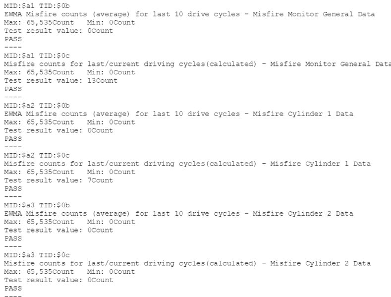

    I have been watching this thread since its inception. I have also been in denial of this issue. Yesterday, I used the Torque app to run some diagnostics on my way home from work (30 miles/45 mins. one way). Below are the results I uploaded to my Drive account from Torque. This tank of gas I am running 87 octane with 10% ethanol. I need to fill up at some point this weekend and will try what @Scooby24 suggested and fill up with ethanol free 91.
    I also ran into an issue while logging with Torque this morning to try and collect more data. My ABS warning and Traction light came on so I pulled over, removed the OBDII sensor, restarted the truck and the issue went away. I really don't want to fry the ECU. I think a few members have ran into the same issue.

    2016 Tacoma Trd Off Road 6sp Auto
    Wow! I have never seen a knock correction so large. What ECM calibration are you running?

    SCS Stealth 6 Matte Bronze on Toyo Open Country 265/70R17, Fox 2.5 Coilovers, Bilstien 6150 w/ Remote Resi, Dakar Leaf Pack, Wheeler's Bumpstop, OVTuned
    Talked to my service manager. They recommend having it towed. I opted to drive it in later this afternoon to have it looked at. They are giving me a loaner for the time being. Will keep you all posted.

    Long story short, dealer will not accept Torque data as sufficient evidence because "if there is a misfire, the check engine light would be on regardless of what your data says". I made an appointment for a weekday when they have time to run Toyota's diagnostics. Shop foreman thinks it's the transmission since I did not have TSB rev 1 applied yet. Guess we'll see. :confused:
