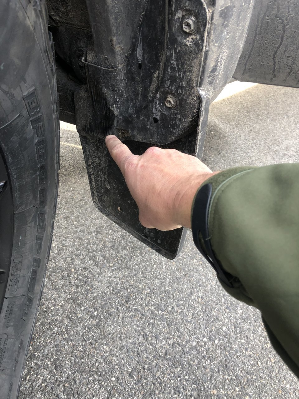

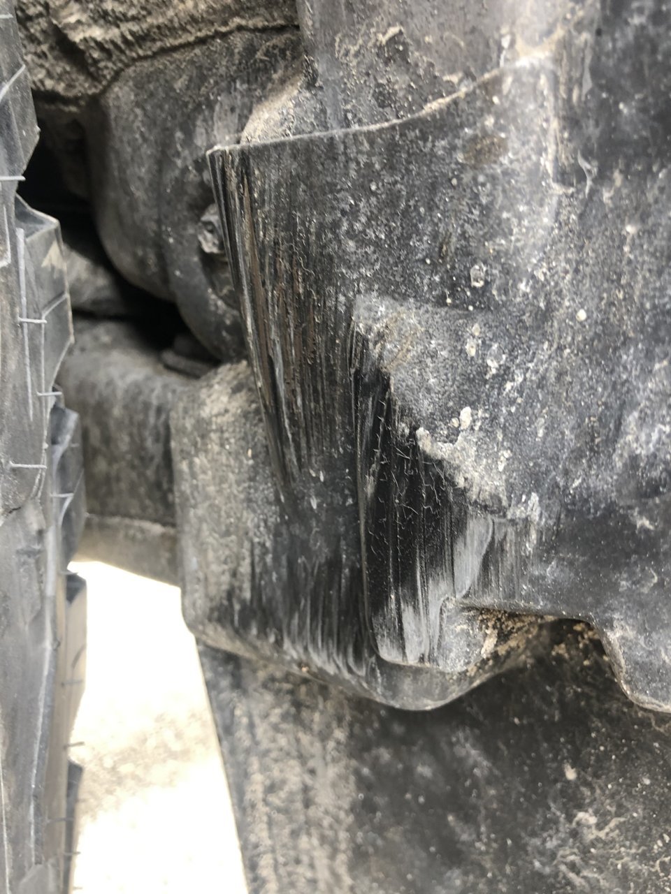

    Couple pics of the small area I’m rubbing. Surprised again this is happening given everything I read about this size. Maybe I’ll start with heat and a mallet to see if I can push that plastic in a tad

    Wait till you go off road, that tire will rub as soon as you compress the suspension.

    My point was there is no way your gonna run nearly a 33” tire with zero lift and not rub. You gonna need to lift it some if you don’t want to rub or go to a smaller tire or like some guys run skinny tires.

    His problem isn’t going straight it’s turning. Without any lift if the wheel is turned and the suspension compresses it’s gonna rub on or off road.
