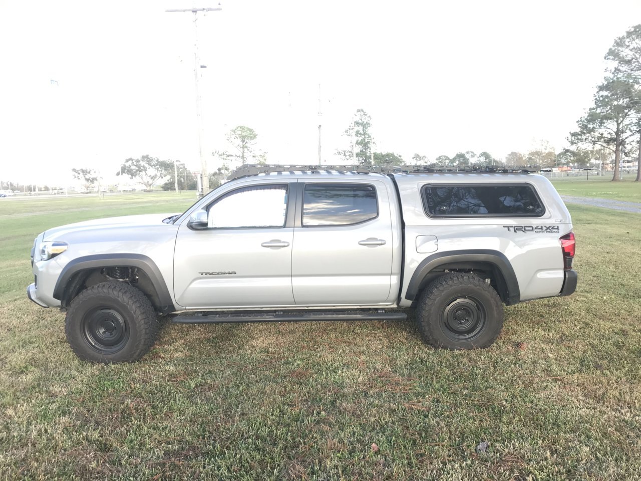

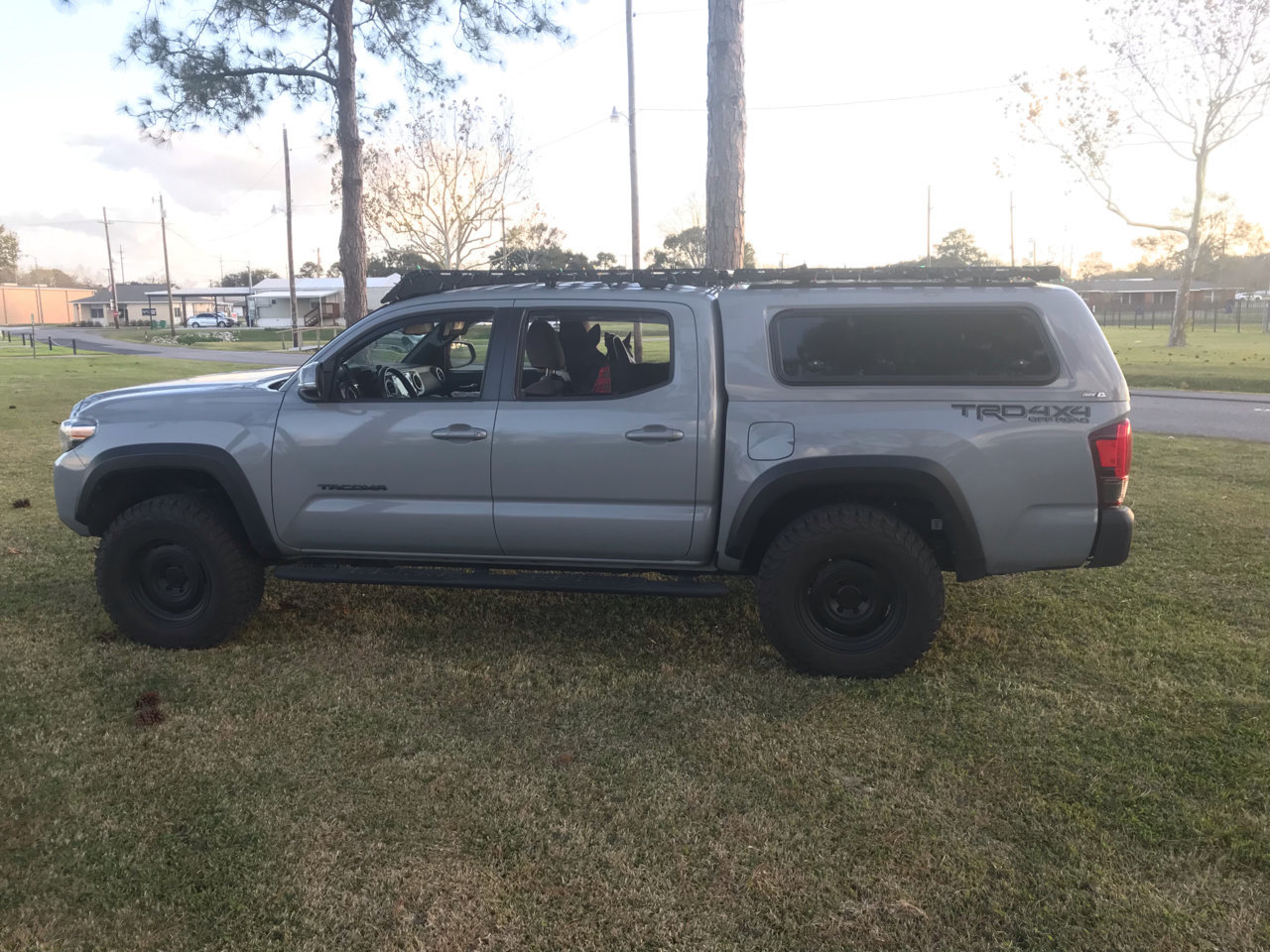

    In October, I lifted my 3rd Gen '19 OF, ~2" in the front, 1.5" in the back. Upgrade components:
    Front:
    - Bilstein 5100 on the 2nd to bottom clip (2" lift.)
    - OME 2885
    - East Coast Gear Supply clamshell bushing on driver's side
    Rear:
    - ICON 2" Rear AAL
    My issue is there's a slight "squat" stance to the truck now, due to my ARE Shell, and a bed box installed. How can I go about remedying this? I can't stand the look of a squatted truck, to each their own, but it's not for me. I've also purchased 2x Fox 2.0 rear shocks, but I haven't installed them yet. They arrived after the shop was able to do the lift. I'm probably going to try to install them myself when I have a spare minute or two this weekend.
    I uploaded two pictures for ref, but they don't really show what I mean. could be the angle I took the photo, but it's quite evident the rear is about 2" lower than level when truck is on level pavement.

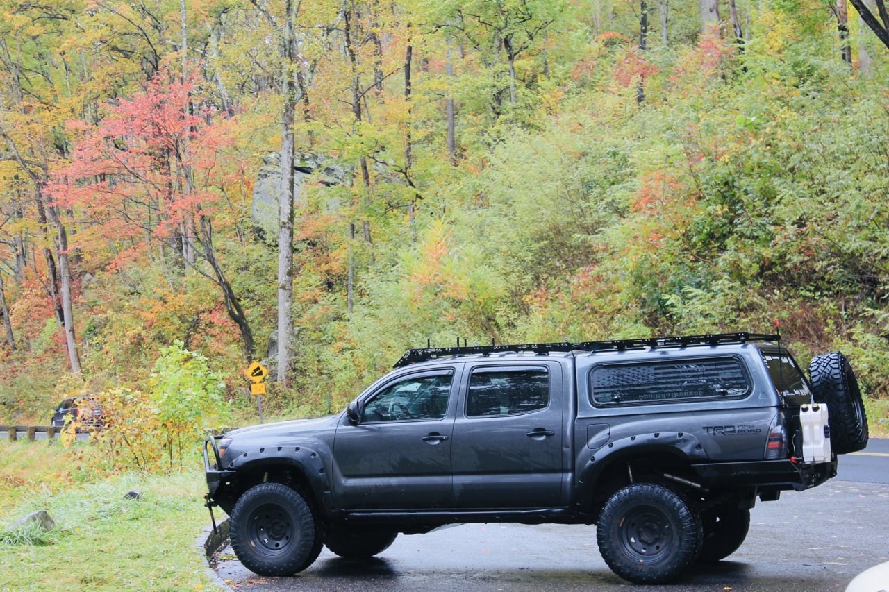

    that looks good, what did you go with in the front?
  13. Dec 28, 2021 at 1:52 PM
    geekhouse23
    geekhouse23 The "Liftman" - @DrFunker
    Jul 14, 2013
    #108251
    15,685
    2GMGMDCSB4WDTRDFTMFW!! TL;DR
    mostly stock, grocery gettin' Prius
    Kings with 650 lb coils

    Front: 23" center of hub to bottom of flare; Rear: 22" center of hub to bottom of flare.
  17. Dec 29, 2021 at 11:58 AM
    #17
    gudujarlson
    gudujarlson Well-Known Member
    Jul 2, 2019
    #298083
    7,175
    Minnesota
    2020 TRD Off-Road DCSB 6MT
    Kings, Dakars, SPCs, 33's, Mobtown Sliders, TRD Skid
    23” is a 2” lift in the front and 22” is zero lift in the back. I think you have room to lift the rear more. It would be good to know your droop numbers as well though. Also you should measure both sides. The passenger side is generally 0.5-1” higher.
