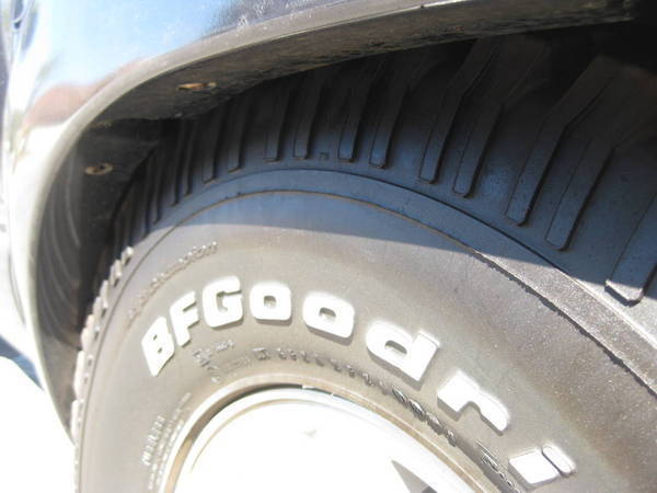

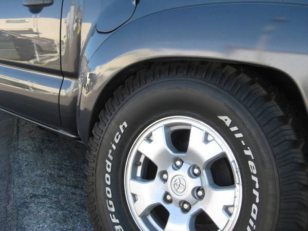

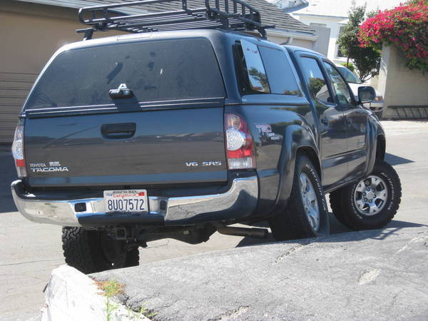

    I'm running Icons all around with 285's BFG All Terrians on stock TRDs OR 16inch rims. I've got spidertrax wheel spacers The front is set right about 2.5-3 inches with no rubbing issues.
    The rear set up is the TSB along with a 1.5" add a leaf. The setup rides fine, performs great with the exception of slight, slight rub in the rear under full compression. I mean when it's fully stuffed to the point the bump stop hits.
    I have some slight rubbing and it's kinda messing with my rear fender. I feel like about a half inch of room would be plenty to alleviate it.
    I don't want to spend the money on a whole new leaf pack, (would be nice) and don't want to lose any of travel I'm getting from the rear. It's pretty good considering the rather mild set up.
    I was debating a rear block to move the wheel down without losing the upward travel, but everything I read about blocks is bad...
    What do you guys think - any ideas? Have you seen 1/2 blocks for sale anywhere? (The smallest I've seen is 1") Other suggestions other than blocks?
    Here's a few pics...

    a 1" block isnt that bad. you could also trim the inside of the fender flare where it's rubbing

    I would not sweat that rubbing. Other than a flexing test, how often will you get into that amount of rubbing?
    Add a bit of spacer under the bump stop.
    You got wheel spacers on the rear too? Take them off?

    The only reason I sweat the the rubbing is bc the fender is staring to get messed up...And I've found on my last few 4 wheeling outings I managed to get myself in situations where they rub. Plus it make a rather unsettling noise.
    I could try taking the spacer off... but think it might look kinda funny if the front have them...
    What could i use to make "space"? I would lose the travel right? Not that it's much...
