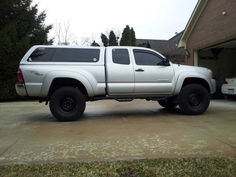

    Facts:
    2007 AC 4x4 4.0, OME 885s/dakar, 285/75/16 on steels, 3.73 rear-ass, towing package.
    Taking a 2200lb Uhaul car transport to VA and bringing back a 2800lbs sedan.
    concern:
    with the 285s and 3.73 I feel that I'm gonna struggle trough mountains and cross-winds... not worried about MPG too much, nor do I hot-dog (75-80MPH) with a trailer, keep it at 60-65max.
    what are some experiences with this situation? there are some 245/75/16s and 265/75/16s both with rims on local CL adds but that's just more expenses that I don't need...
