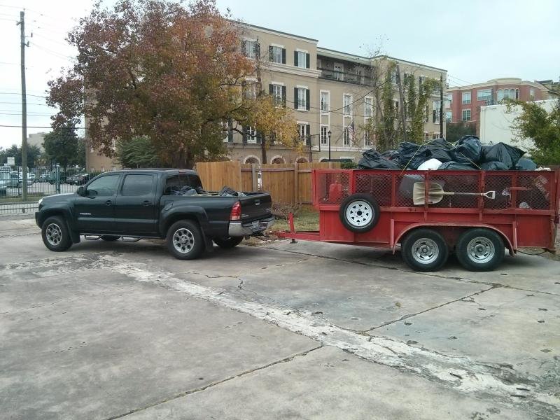

    So I have a slight whine coming from the engine for about a week. A few days ago I had to tow a tandem trailer with some construction trash. Not sure how much the trailer weighted but the taco pulled it fine. Now the taco has some rubber burning smell from the engine and rough idle/slight vibration as I am slowing down to a stop. No CEL's. So is it the idle pulley, alternator, or what else can it be? I had to leave the taco broken since I had to go out of town. Will be back tomorrow to start trouble shooting. Hope you guys can point me in the right direction. Thanks!
    This is what i had to tow across town:

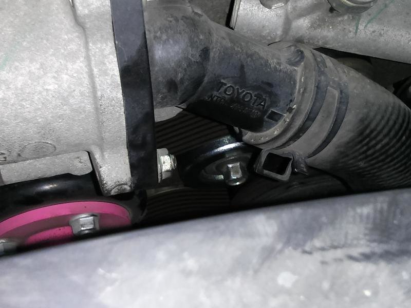

    So I ended up just replacing the tensioner pulley and belt. Only think is I don't remember the belt sitting so far back on the tensioner pulley. Can u guys confirm I have it correct?

    Something else is still amiss with the engine. Making a weird noise. Time to take it to the mechanic. Can't have my truck down too long trying to figure what is wrong. My MS3 isn't cutting as a work truck.
