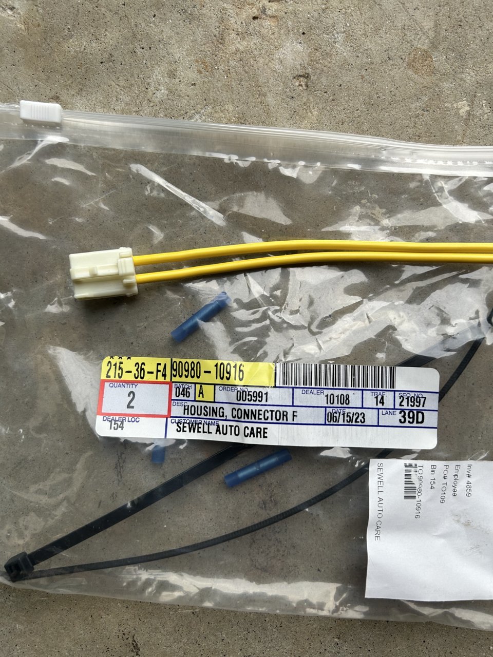

    Check the electrical plug going in to fan motor. Mine was doing same thing, and stop working altogether sometimes. The plug and one wire was bad. Rewired a new plug in and haven’t had the problem since. Matter of fact, getting ready to do my son’s motor also. B903FDA6-D596-4003-8C74-68B3FEC73262.jpg
