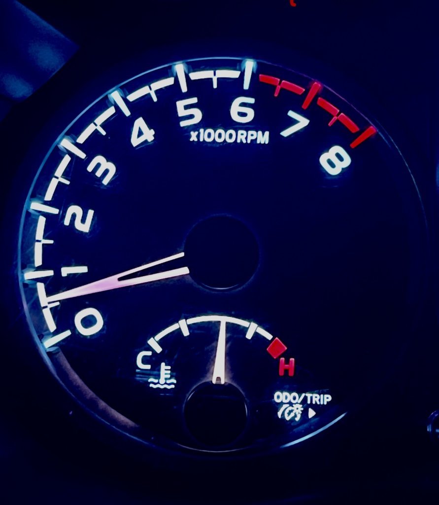

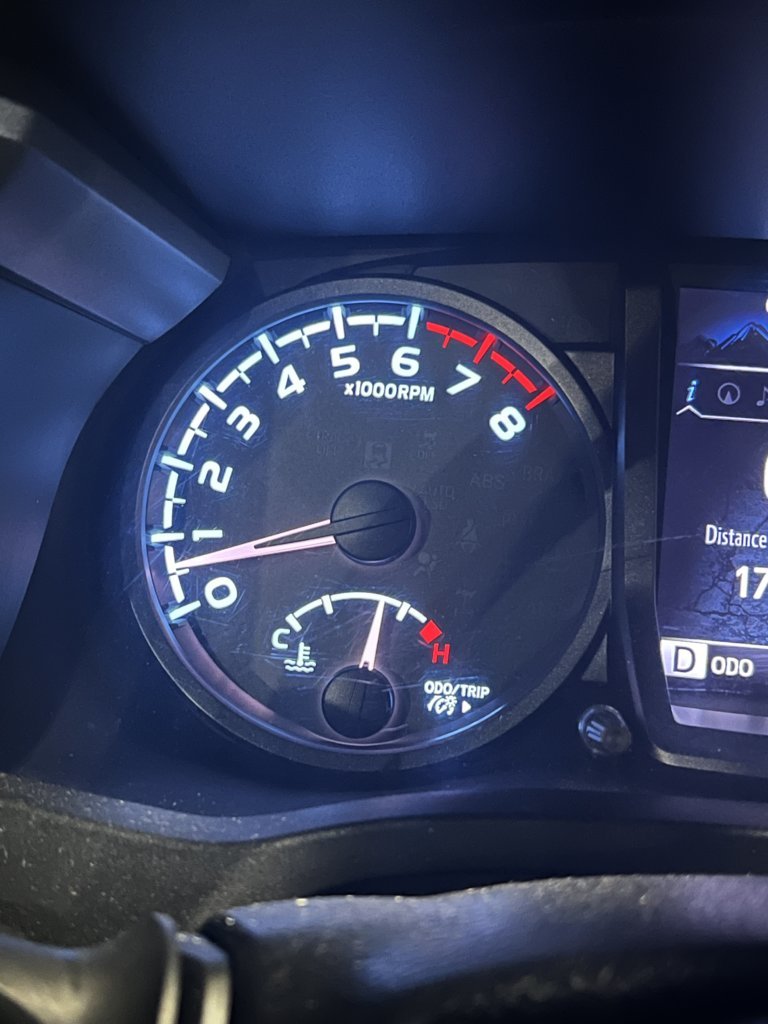

    Truck engine slightly overheated after prolonged idling. Temp goes down within seconds if I press the gas just over 1K rpms. Ambient temp is between 85-100 F. Coolant level good, oil level good. Pressing the gas (higher rpms) will result in higher pulley speed which will cool down the system but should the ECU take care of it and should I be concerned about radiator fan clutch (considering high ambient temperature and pronlonged idle time of 1-2 hours)? What other things would you check on? Note: it’s does not completely overheats even if I don’t press the gas.

    That's not overheating, and idling @ 100° that temp wouldn't worry me.
    Without the forward air flow, I'd actually expect it.
    Is idling for hours on end something you do often?
    If it was my truck, and it was avoidable, I'd avoid it.

    Until it gets in the red part near the "H", you have nothing to worry about.

    100°, a mechanical fan, and idling for 1-2 hours? Yea, it's gonna get a little warm. As long as it isn't near the red zone and the dash isn't warning you you're good. I would however change the oil more often if you idle like that a lot.

    The current condition is still safe as others said. However, your fan clutch may be slipping or you may have mud/debris packed between your condenser and radiator. Usually the fan clutch fails the other way (fan doesn't slow down when coolant is cold) but I guess anything can happen.
    Did you have A/C on while idling? The idle rpm should increase with A/C running.

    Thanks everyone for the replies. It has done this before but the temp gauge needle was just slightly over which was not concerning to me (see pic example). The more recent times it has done it, it’s been slightly higher than usual. Note, it does not do it often, only when idling for longer periods of time. Unfortunately, I do run it like that 2-3 times a month since I cross the border very often and during holidays the border crossing lines can get long and slow.
    Although, I am not concerned anymore. Is there any recommendations to make sure I’m keeping my cooling system as efficient as can be since it’s a hot summer and I have to run it on idle frequently?
