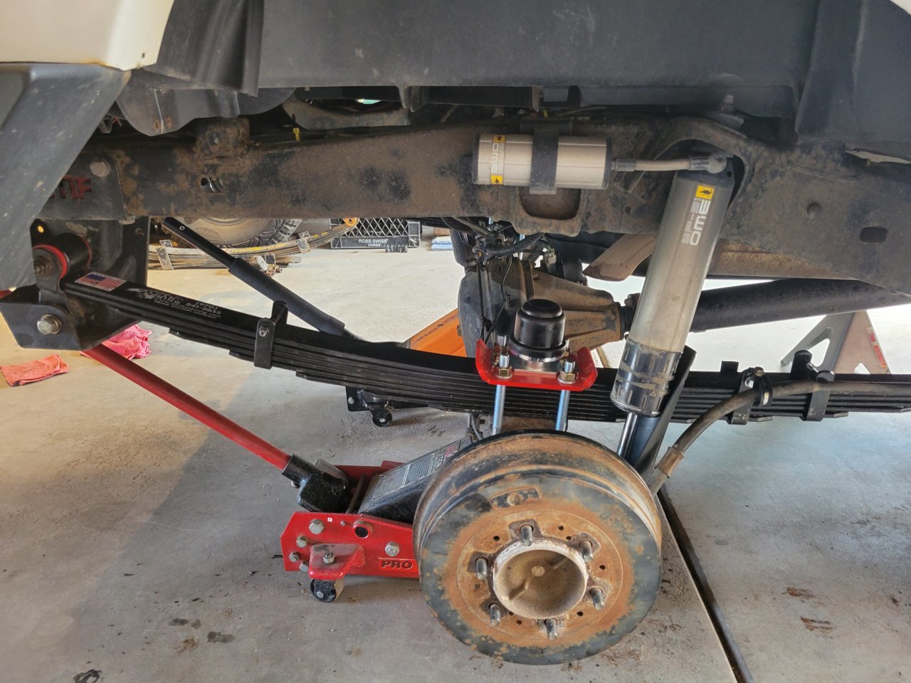

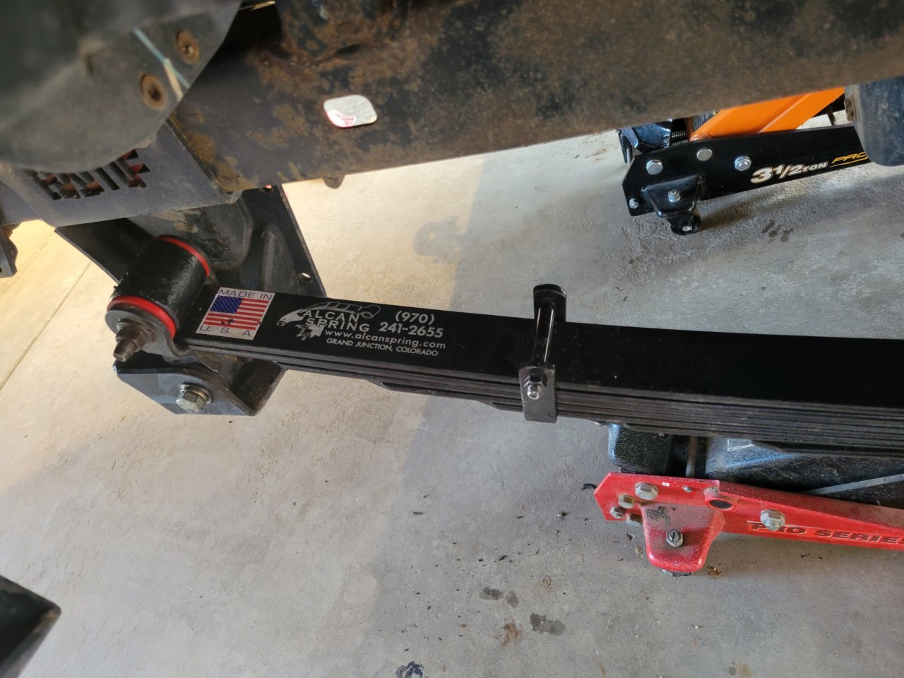

    You may want pull those leafs off and trim the second one down…
    @ARCHIVE - the second spring is going to bind in the shackle like OME and Dobinsons, right?

    Yes, especially with that brand shackle. It looks like the 2nd leaf is hitting the bends on the shackle and looks like it may be bending the top 2 upper leaves upward slightly into a negative arch, would get worse loaded or during compression

    I hear ya, I did that on the Dakars that these replaced. The pics don't really show it but it was addressed.
