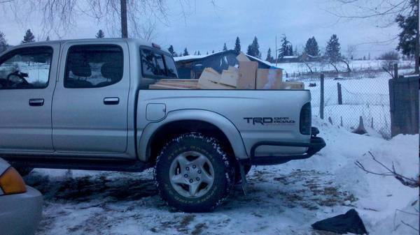

    Did some wood hauling for a friend yesterday:

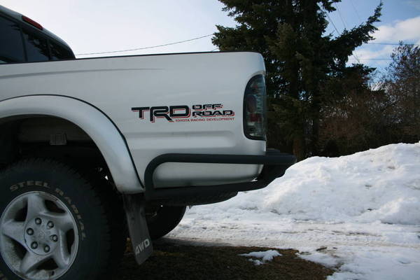

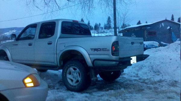

    I finished installing my rear bumper license plate lights. (had to drill the holes a little wider on the allpro to get the screw in.)
    I also Rain-x'd the outside windows and headlights, windex'd the inside windows. I would recommend Rain-X! For $7 you can't go wrong.

    Took a few more shots of the bumper with the license plate lights installed:

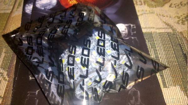

    Got my Switchback LED's today:
    Waiting for the ebay LED flasher to come before I can get that installed.

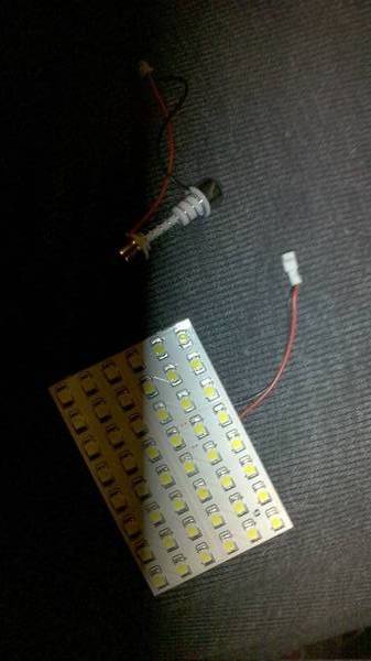

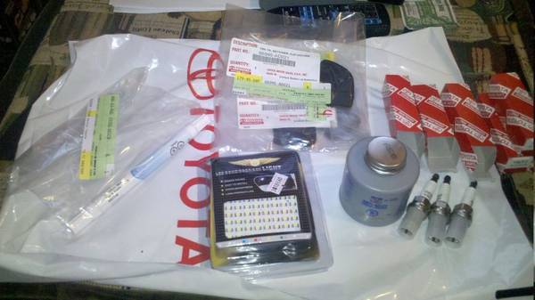

    Spent some money at the dealer today, also led dome came from hong kong!:
  12. Mar 24, 2011 at 10:13 PM
    #72
    SlimDigg
    SlimDigg [OP] We Back!!
    Sep 1, 2010
    #42613
    1,428
    Calgary, AB
    Coming Soon....

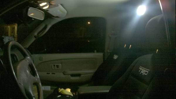

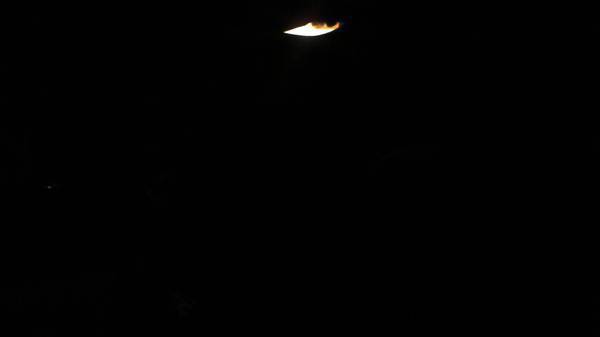

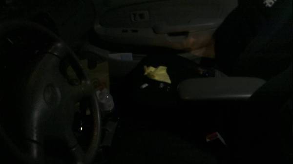

    LED dome installed:
    Stock:
    I took a key, wrapped in it 4 or 5 napkins, wedged it in the light and basically turned the key. Light cover popped off.
    I'm told if it doesn't turn on, switch the bulb around. I got it first try and boom:
    Finished:
    Keep in mind these photos are taken with my phone.
    Pros: BRIGHT. This is what should happen when you open your doors.
    Cons: They don't work correctly with the door open and on settings. It works properly with the key turned to acc or on. I also found it works properly without the key if one of the map lights is turned on.

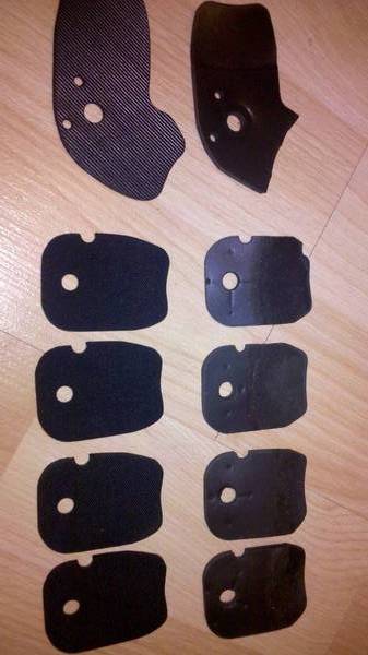

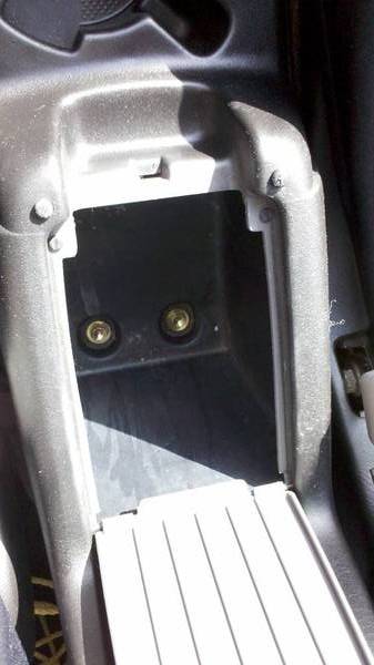

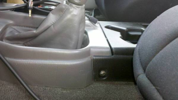

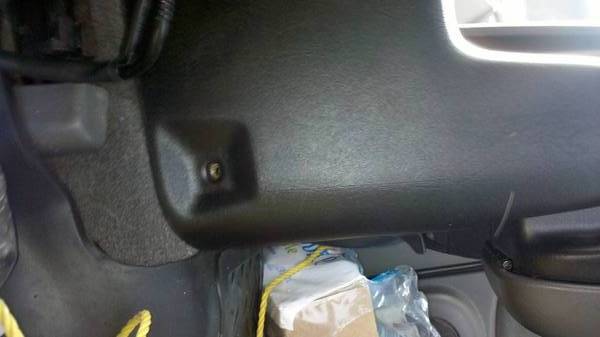

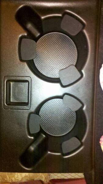

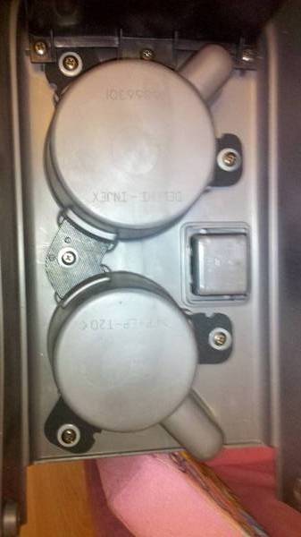

    How to replace cup holder tabs:
    66995-AD011 RETAINER, (4)
    66995-AD021 RETAINER (1)
    Tools:
    Phillips screwdriver
    10mm socket and wrench
    Before:
    Remove these two bolts:
    Remove this screw on both sides:
    Remove this bolt on both sides (move seat forward for easy access):
    Remove each screw and remove old cup holder tabs, screw in the new ones!
    Done:

    hey where'd you grab those new cup holders tabs? they look really sweet!
  20. Mar 27, 2011 at 10:12 PM
    #80
    SlimDigg
    Sep 1, 2010
    #42613
    1,428
    Calgary, AB
    Coming Soon....
    Dealership
