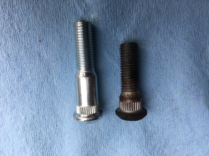

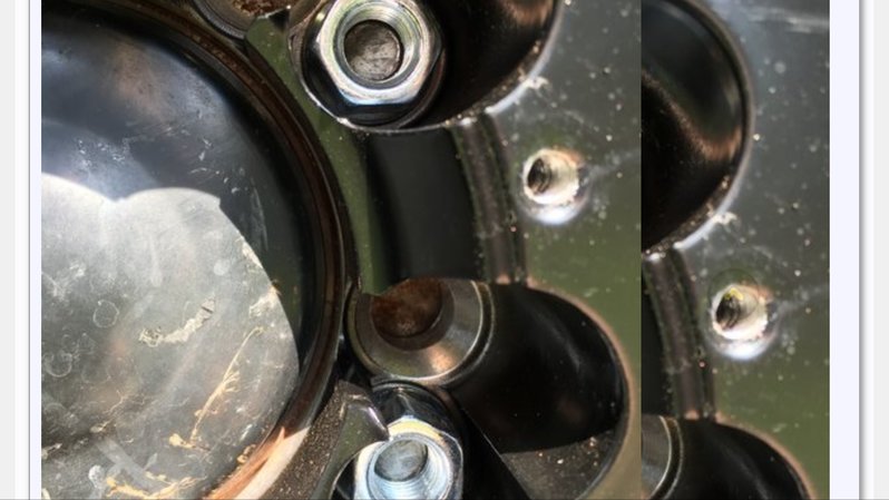

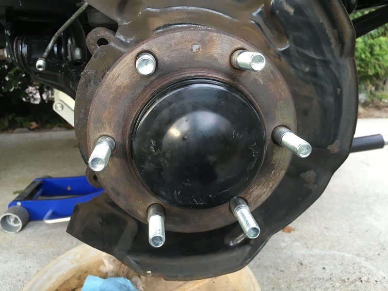

    The brakes work great now and I did go back to the original shop not because of the brakes but because they never informed me how short my lugs where after they mounted my wheels that I ordered with them
    I had to pull the wheels, calipers rotors and back drums off to bang out the old studs and put longer ones on
