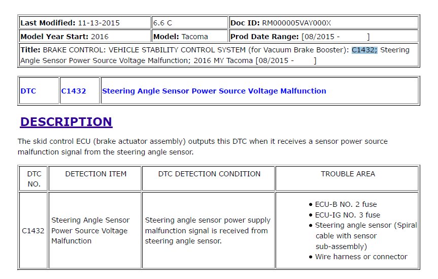

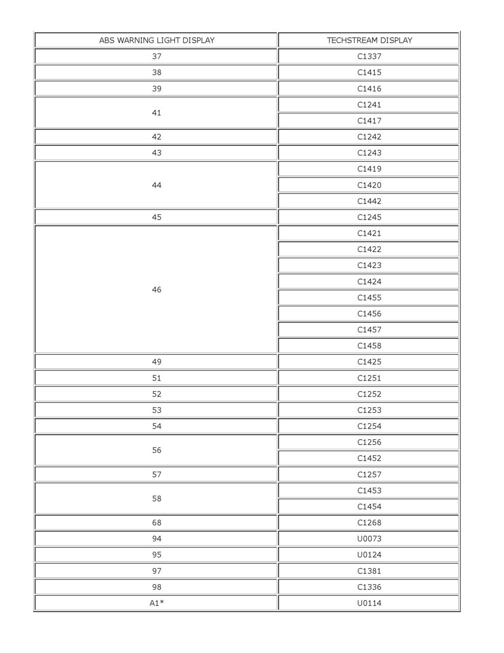

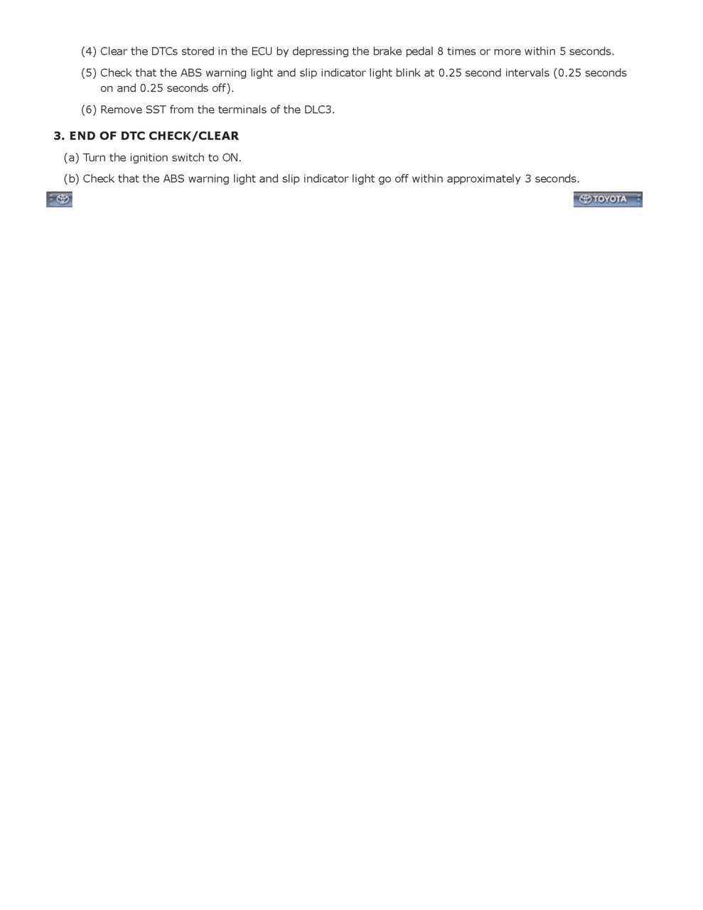

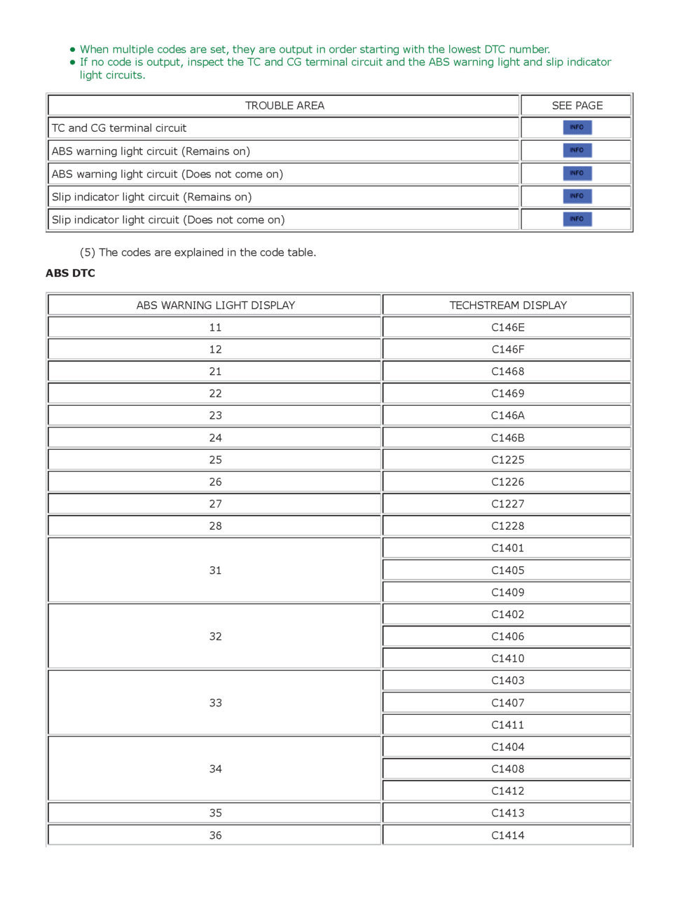

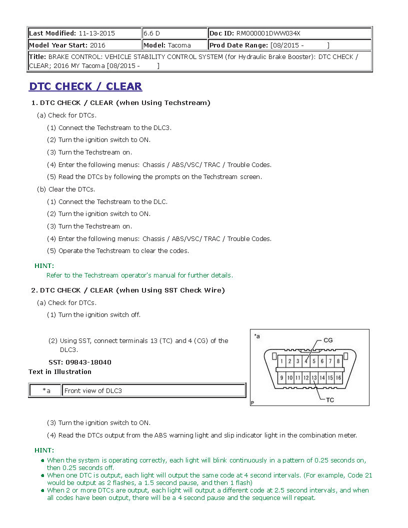

    Just to help anyone who has the same issues as me, I will walk you through my diagnostic steps. DTC check on the slip indicator light shows a code 31. Which is a
    C1432, C1433, or C1434 in Techstream. Fuses test good, clearing the code does not solve the problem or allow a successful Zero Point Configuration. I think will need to know the actual Techstream code, or I will have to diagnose each one of those codes individually.
    In case you are curious how to do this process...
