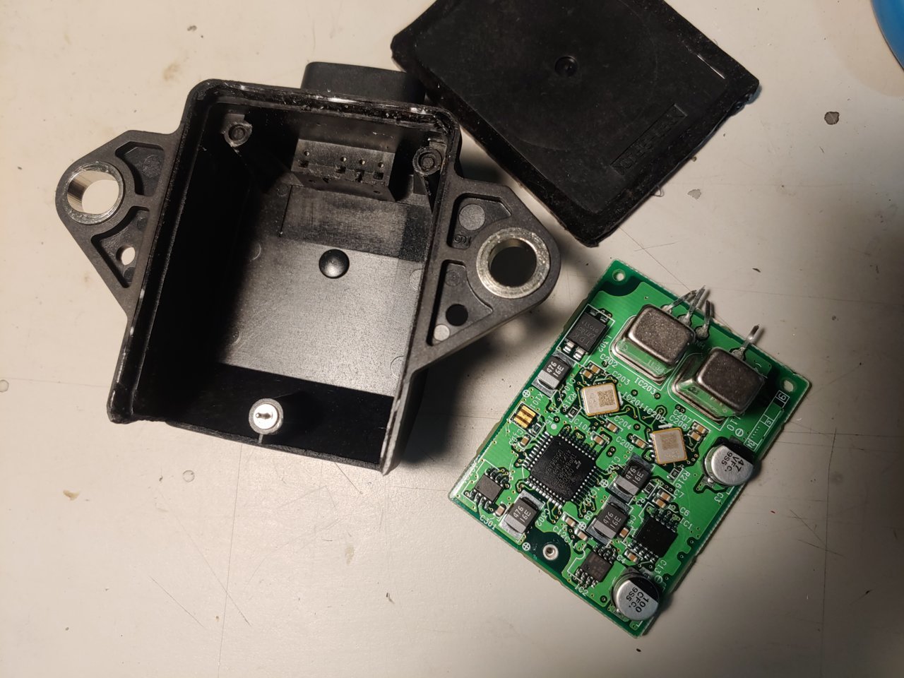

    I replaced my YAW rate sensor today with a $15 shipped one from ebay (new OEM toyota the cheapest I seen was $300) and it WORKED!!! I reset it, recalibrated it and it's all good! THANK YOU EVERYONE FOR THE HELP!!!
    here are some photos of the inside of the sensor (I cant just throw stuff away without ripping it apart and investigating what makes it tick) but i see no clear visual indication is faulty

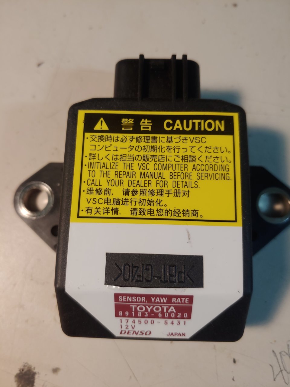

    Good news indeed! I got a used OEM from eBay (part# 89183-60020). Soooo happy I didn't need to take it in to Toyota garage!Screenshot_20201018-190738~2.jpg

    That's a good find for $15. :thumbsup:
    I would personally double check all outputs with techstream but sounds like you're good to go.
