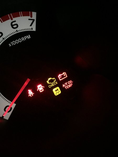

    Hey guys, I have had this issue for a while now, and still haven't been able to fix it. I first noticed this problem after I installed my remote start, which makes me suspect I screwed something up. I have tried 2 different code readers, neither of which gave a code and I also cleared both and the lights still on. I then thought since I badly needed an alignment, the VSC got knocked out. Got my alignment done and I calibrated the VSC with a paper clip. Still, the lights on. While I was at the dealership for a service, I told them about it. They said it would be 105$ just to look at it. They said the sensors looked fine, whatever sensors they can see without disassembling stuff.
    The light I am talking about is the one that looks like a car. The others are on because the truck isn't on lol. Also, the maintenance light and the ABS light are not on.Photo Nov 14, 8 45 25 PM.jpgAnyone have any idea whats going on?

    I had this problem in my FJ Cruiser...the traction control light just randomly came on and stayed on even though I had not done any work to the truck. After some research it appears to be a common issue. Everyone seemed to find a different cause but most (myself included) were able to just unplug the battery and plug it back in after some time. It hasn't come back for about 4 months now. Problem solved! Lol

    That didn't fix mine sadly
