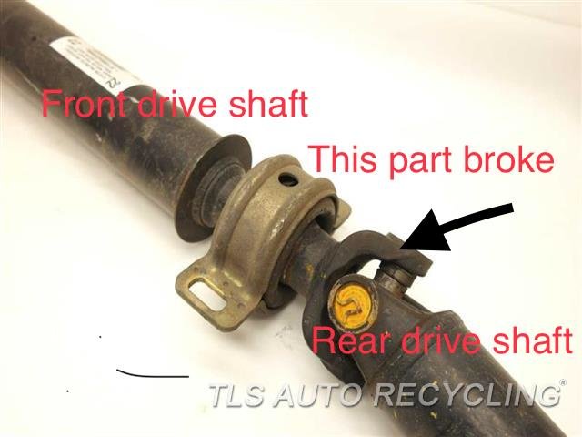

    has anyone have luck finding a new slip yoke for an 05 Taco without buying the whole driveshaft assembly?

    Thanks, I have been looking online and can’t seem to find that part anywhere.. websites that sell slip holes don’t offer a Tacoma one... so I am Looking for help I can’t afford to buy a brand new driveshaft too much money!

    Note that the yoke you are pointing to doesn't actually "slip". There is another yoke that does the "slipping". Make sure you get the correct yoke. Like I mentioned, I'm not 100% sure on that part I posted.

    It's also possible that 2wd and 4wd are different.

    The flange on the part with the arrow is the one that broke.. so I could not find that part alone.. only the full shaft and at the moment I don’t have 500-1200 bucks to throw down..

    There should be numbers stamped in the yoke. Might be wise to call Dana with those numbers to confirm.

    I have a spare drive shaft from my Prerunner.

    Will it fit my 2006 PreRunner 2wd V6? My truck is an access cab.?
    And if so how much are you asking for it?

    Yes it fit Could do $30 shipped
