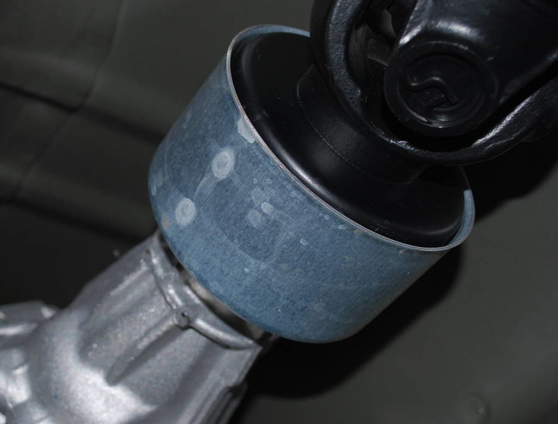

    Hello all. I'm a newbie but I've searched and read MANY TW threads on this and can't get a clear picture of where to attack this. My 2005 extra cab 2wd has the classic thump that seems to be a slip yoke issue. I did the cheap ubolt axle wrap mod on the leaf springs first, but that didn't fix it. My issue is that I can't tell exactly where the slip yoke is, and I don't want to take anything off until I do. Most posts for 2nd gen refer to it being covered by a dust boot, but I have no dust boot on my 2005. Just the two solid shafts connected at the bearing. One post mentioned "thinking" that the yoke is where it meets the transfer case, but that doesn't seem right. I'm "thinking" the slip yoke is either where the rear shaft connects to the differential, or at the back end of the front shaft where it joins the rear shaft at the bearing. I saw the info on the best lube to use, so I'm ready to go once I figure out where the dang thing is. Hopefully it's an easy answer - much appreciated.

    There is the slip yoke on the 2wd trucks, and the slip joint on the 4x4's.
    The slip yoke is at the transmission, the driveshaft actually plunges in and out of the transmission.
    The slip joint on the 4x4's is after the center u joint and has the dust boot... its setup this way as you have a transfer case with a fixed flange.

    Remove the driveshaft and inspect the internal splines of the yoke with a flashlight .
    You will lose fluid when removing the driveshaft
    The splines inside the yoke are softer than the output shaft splines on the transmission as its cheaper to replace a yoke over a transmission output shaft .
    Are you automatic or manual ?
    If you have a manual transmission , you can get away with adding spline lubricant to the inside of the splines but if you have an auto , I would be certain that your spline lubricant is compatible with the auto trans fluid .
    If the inner splines are worn out , we usually replace the yoke .
