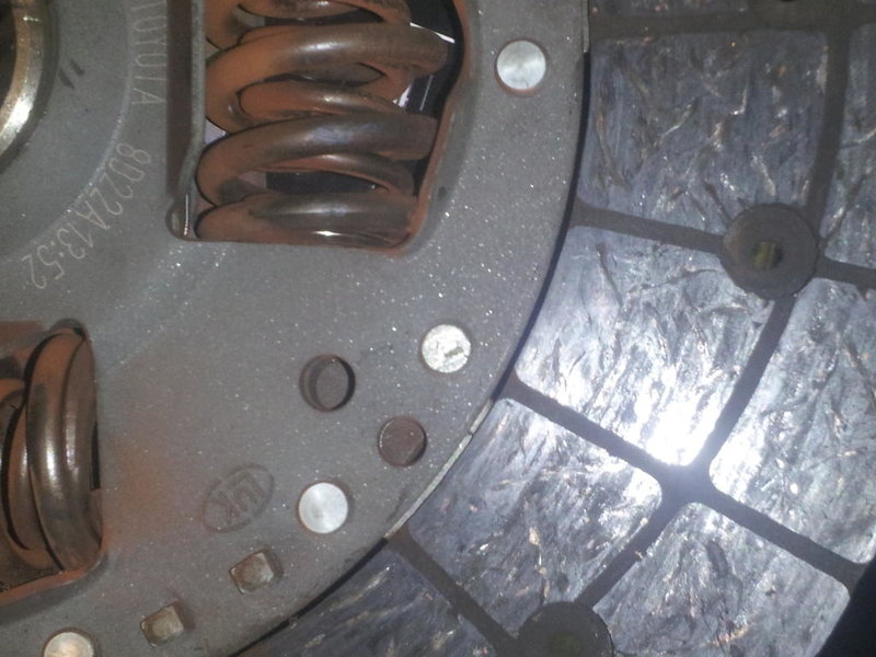

    Mine went out at 21,000 miles. Started slipping and out of warranty. Don't let the dealer pretend like they don't know about it. It's a known issue. Call Toyota CUSTOMER CARE.

    You need to avoid using the higher gears on inclines/long & or steep hills, don't lug your engine, 2nd gen clutches have issues (still) & if clutch is going out under revving/lugging is really going to put the final nail in it... As bad or worse than over revving...

    The issue is the crappy pressure plate. The clutch doesn't actually wear out with low miles. This is mine at 21k. Still lots of meat and slipping quite a bit.

    I should've taken a photo next to the new plate. They were nearly the same. The new clutch has a stiffer pressure plate and much better feel.
