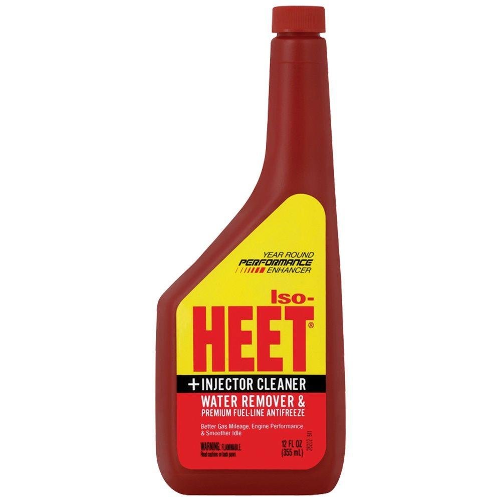

    Try a bottle of red heat11E341DE-EFC4-4582-A6B3-2076472AD5DD.jpg Then maybe a gunk 5 minute flush then let it drain overnight fill with oil and change the plugs. Clean the maf, too. Edit: Man, that’s a nice ride you’ve got there. Make sure all the little vacuum lines aren’t dry rotted and replace them if necessary :rolleyes:
