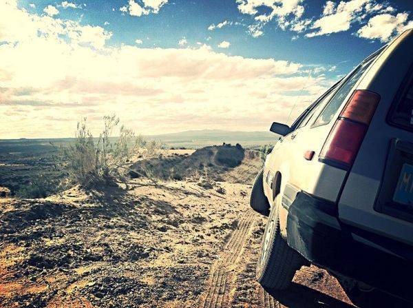

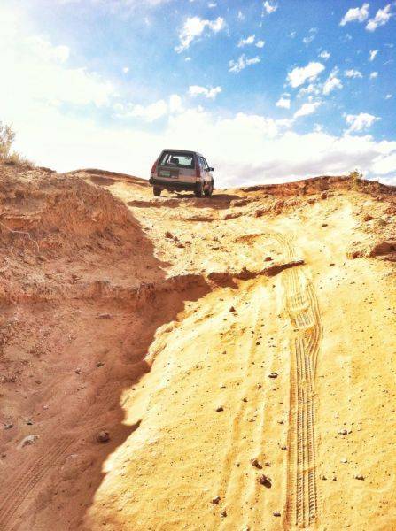

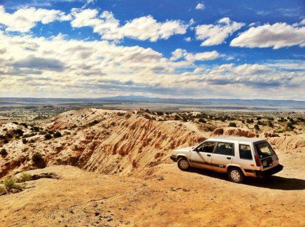

    [​IMG][​IMG]
    Mods:
    195/75r14 BFG All-Terrain K/Os
    14" Miata Wheels (Painted White)
    Weber Carburetor
    Custom, Fabricated, Front, Adjustable Coilovers (2-3" lift)
    198something Nissan Pathfinder rear coils (about 2-3" lift)
    188someting Ford T-bird Rear Shocks
    AC delete mod
    20% Tint
    Mostly blacked out Interior
    Mods already in process or to occur within the next few weeks:
    Volvo 940 100amp Denso Alternator form junkyard
    Sounds System
    Future Mods:
    4a-ge swap (which 4ag depends on how much I can build the tranny/case to withstand clutch drops in low gear, in 4wd, on asphalt...... ;) but hopefully a 20v silvertop or blacktop from Japan :D)
    Built Tranny/Transfer Case
    4.10s
    Rear SAS with Corolla All-Trac or GTS axle? (LSD FTW)
    Should be fun. :cool:
