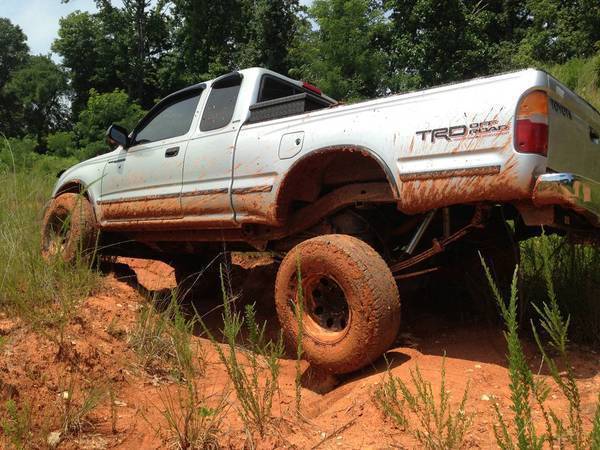

    fj60 front, fj80 rear, full hydro, 5.29's, welded, twin sticked 2.28/4.70 duals, 39.5's, inboarded 63's
    Silas, how close it too close to overextending a shock? With my current setup at full droop my shock is 29" eye to eye and the shock itself at full extension is 29.95". Is this too close? Here's a pic at full droop. The tire is 1/2" off the ground

    Impressive!!!!! That's pretty close.... Keep an eye on it... I wouldn't let it get within half an inch. You'll probably have to change the shock location or something soon. The more you use these leaves, the more they will flex...... ;) You're barely breaking them in! :D

    Thanks man! I figured I'd have to change them, especially when I go longer shackles. My crossmember/upper shock mount has 2 mounting locations and I have them on the innermost now so I think if I move them out and then move the lower shock mounts up an inch then I'll be good.. for a while haha.
