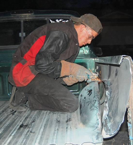

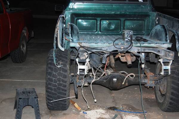

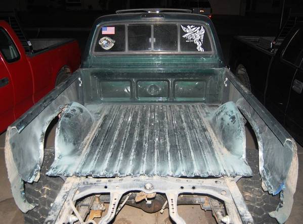

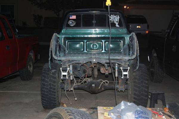

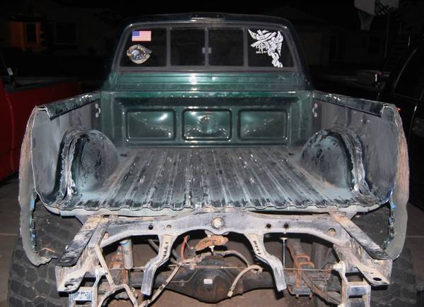

    Didn't get any progress done tonight, but here are some pictures from last night

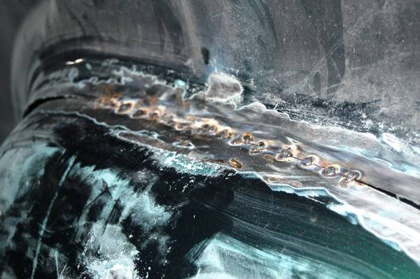

    Finished cutting/grinding for the dovetail and put a couple tacks on her just to keep it in place for now..

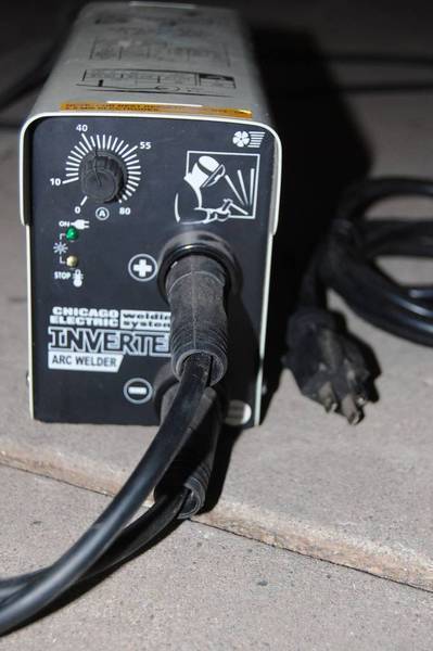

    Yes, my tacks suck, but you try tacking sheet metal with a 110v stick welder!!! :p

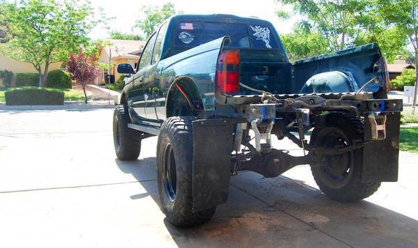

  5. Jun 16, 2012 at 12:01 AM

    :D Duct Tape FTW? hahahahaha

    Your tacks that suck are better than mine :anonymous:
    Btw, probably a stupid question but how far back did you cut for the dovetail? I'm assuming all the way back but for some reason I'm wondering if you stopped at wheel wells? :notsure:

    Looks good. Excuse my ignorance, but what are you doing with the tailgate once you dovetail the rear? Won't the tailgate not fit anymore?

    You do the same thing to the tailgate as you did the bed. Cut a section out and weld it back together

    ahahaha lies! Just about everyother tack is burned through! :eek: Thinking about just getting a harbour freight 110v MIG to finish up.....
    Not stupid, man, I cut all the way to about half an inch before it started going vertical on the cab side. It just starts getting pretty narrow at the wells since I'm only taking 4" of each side...
    Thanks! Jon is correct, I'll basically just take an 8" wide section out of the tail gate and weld it back together with shortened cables on the inside and anything I have to do to make it work. :)
