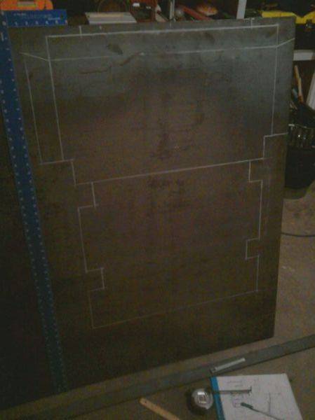

    Picked up some 1/4" plate for my skids! :woot:
    Also started getting the basic design down.

    Nice, how are you going to cut it?

    lol My 4 1/2" angle grinder...... and LOTS of discs!!!:eek: I may have to upgrade to something a bit larger, but we'll see how it goes. Then whiskey bends with the grinder and my Harbour Freight 110 stick welder.:D
    I shall put the "ghetto" in SlodgHetto. ;)

    Do you have any other suggestions, Steven? My assortment of tools isn't small, but I definately don't have a full shop..... :eek:

    Got a 10 pack of 7" cut-off wheels for my circular saw, and that seems to be working fairly well... Just have to let it cool of every 4"!!! lol :eek:
