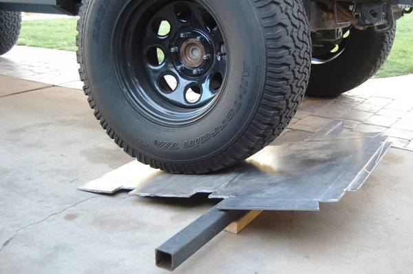

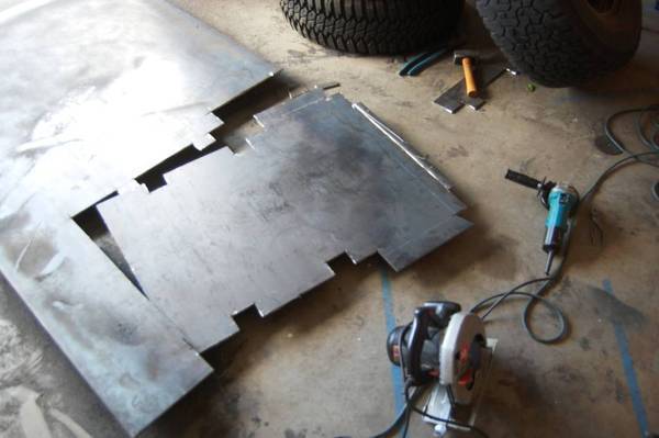

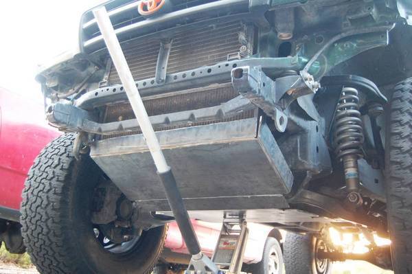

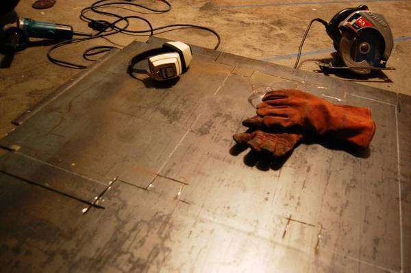

    well a large vertical band saw would be pretty awesome, or a torch/plasma cutter.
    The grinder would be my choice if you don't have access to those tools though.
  2. Apr 13, 2012 at 4:20 PM
    #42
    Slodgetto
    Slodgetto [OP] Über Posre
    Jan 18, 2011
    #49483
    9,276
    Silas
    Yeah, a vertical band saw would be sweet! :eek: I'll give the grinder a go then.... Maybe I can just switch between the circular saw and grinder every couple inches to let them cool off.

    Throw it in the bed and come down here, our machine shop has a vertical band saw:spy:
    Might go through a few blades though :laugh:
  4. Apr 15, 2012 at 1:38 PM
    #44
    Slodgetto
    Jan 18, 2011
    #49483
    9,276
    Silas
    lol This seems to be working ok... Off to the store to get more ginder wheels though. hahaha just past the halfway point...

    Dremel. I suggest the 1" cutter.

    lol I was about to suggest a hack saw but that sounds better.

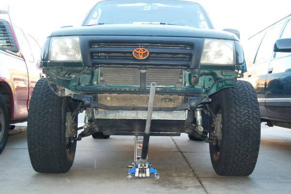

    Started welding last night... Just some teaser pics:

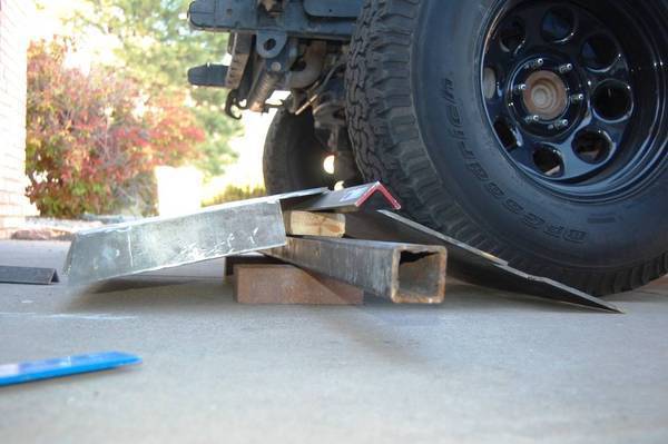

    So how much does that sucker weigh? :D

    lol I haven't weighed it.... I'll have to figure it out when it's all finished up:D

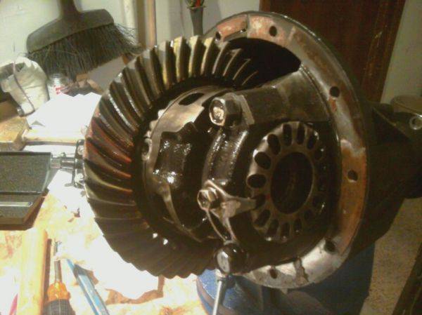

    Also, started regearing my rear diff with Nitro 5.29s and solid collar. Got all the old stuff a pressed out and new bearings/races pressed in with only destroying 2 old bearings and 1 oil retainer... :eek: I think I've got a good strong pinion preload at 19 in/lbs (slightly over spec) after about 6 tries.... Next step is to get the right backlash/carrier bearing preload set and then run some contact patterns to make sure my pinion depth is ok. With my luck, It'll probably take like 10 tries before I get a good pattern. :(
    Here's the old stuff just before I ran some measurements and took it apart. Carrier and pinion total preload was only at 3in/lb rolling torque!!! :O Backlash was ok at an avg. 9 thou and the contact pattern didn't look bad at all...

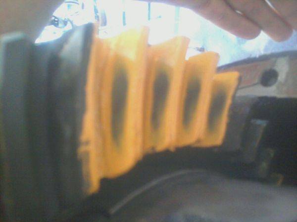

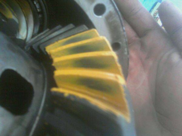

    I've been working on re-gearing my rear diff for the past few days and I think I've finally gotten a pattern that I can accept. Any opinions? Backlash is perfect at an avg. of .006". The pinion was way to shallow on my first attempt, so I added .010" worth of shims and got this. At first I thought it is a tad deep, but I'd rather er on the side of too deep than too shallow. Also apears to be favoring the toe a bit on the drive side wich ZUK said is desirable for larger tires, so that is a plus. :cool: Thanks for any input! :D
    I think it's finally time to slap her in.

    That is pretty close to what my pattern looked like front and rear. Pop em in and have fun. You do the front yet?

    I did! :D haha Took it for test run as well, and everything looks/feels/sounds good! :woot:
    And no.... haven't done the front yet. :eek: that's next though...
