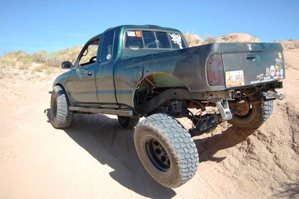

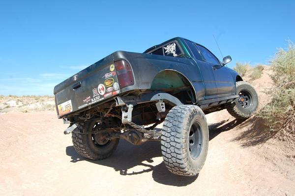

  20. Sep 23, 2012 at 5:10 PM
    #600
    Slodgetto
    Slodgetto [OP] Über Posre
    Jan 18, 2011
    #49483
    9,276
    Silas
