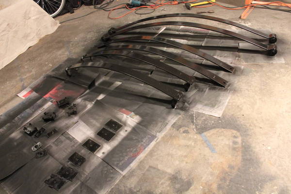

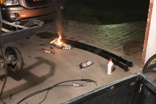

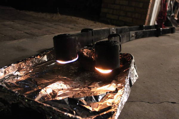

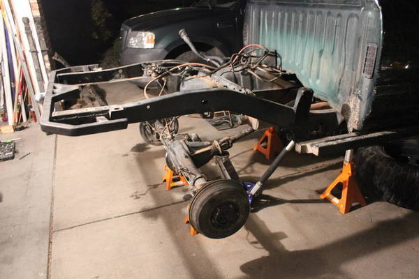

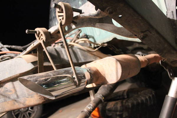

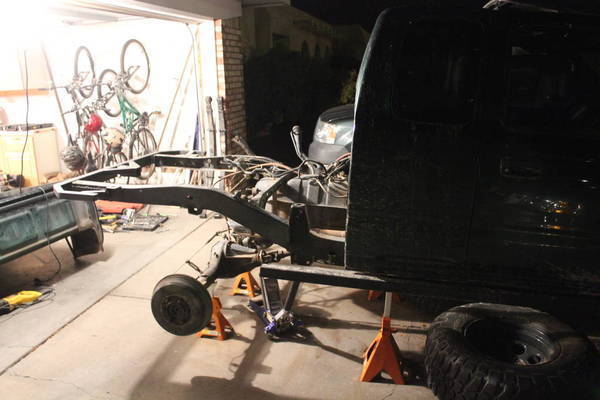

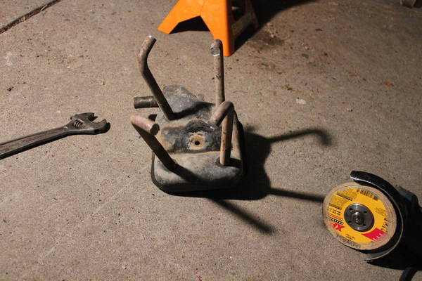

    Operation Uber Leaf Spring Flex is under way...
    Plan:
    1/4" plate boxed rear frame
    2" x .125" box tube crossmember 1.5" aft of axle
    Re-built 63" Chevies (2 leaves each)
    3/8", 6" eye-to-eye
    1/4" plate front hangers 7.75" foward. Frenched into frame?
    1.5" x .125" cradles with Ballistic 2.63" creeper joints for shackle hangers
    Custom u-bolt flip with 3/8" plate
    re-locate e-brake cable to follow spring (to allow full droop)
    Triangulate 14" 2.0 Fox Pro Series Shox
    So far....
    Took apart the chevies I got from the junk yard about 10 months ago.... :eek:
    attaked them with a wire wheel
    self-etching primer and some black gloss
    burned out the old, cracked bushings
    removed my old suspension and ground off extra crap...
    I also welded on a bigger exhaust tip, since it was accessable. :D

    Dude that exhaust tip is awesome! Rollin' coal for dayzzz haha. But seriously nice work.
