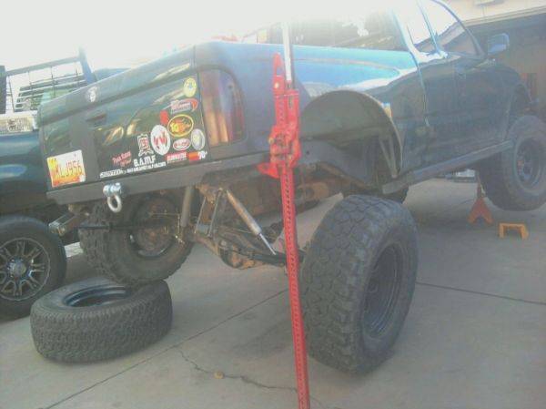

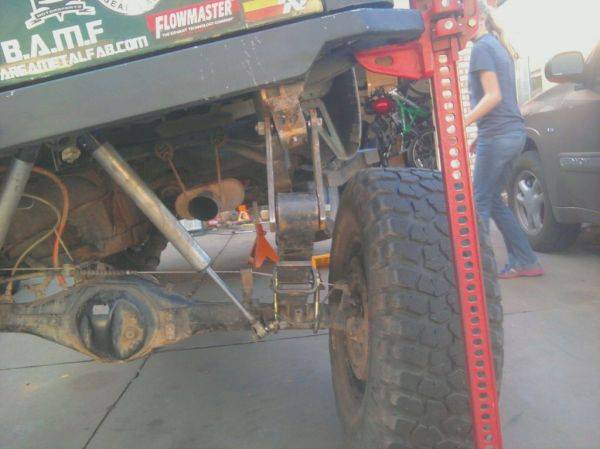

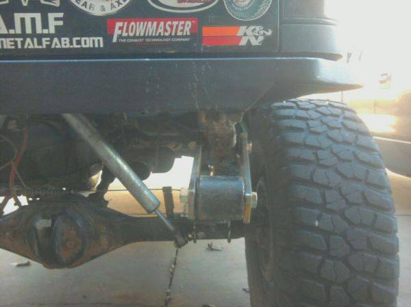

    I think it worked guys.... Going to finish up the bump stops in the morn and then hopefully go to the Puerco to test everything out again... I'll take better pictures and get measurements then.
    Re-drilled 9/16" holes in the perches
    Everything installed, shackle at ride height.. springs are dovetailed by half an inch :laugh: so not much..
    but it seemed to make the difference i was looking for. now i've got MUCH less twisting/binding at shackle/spring joint
