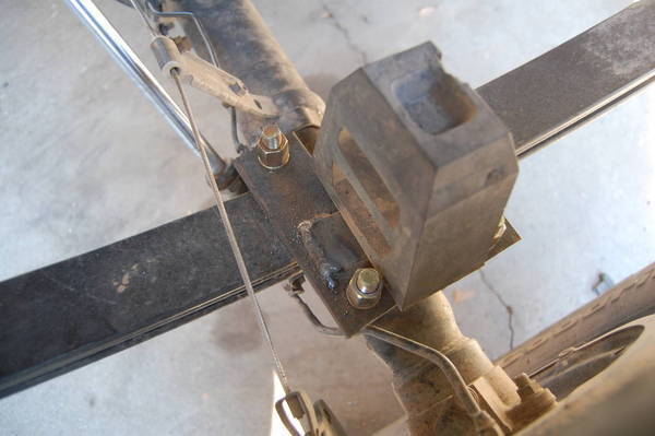

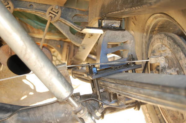

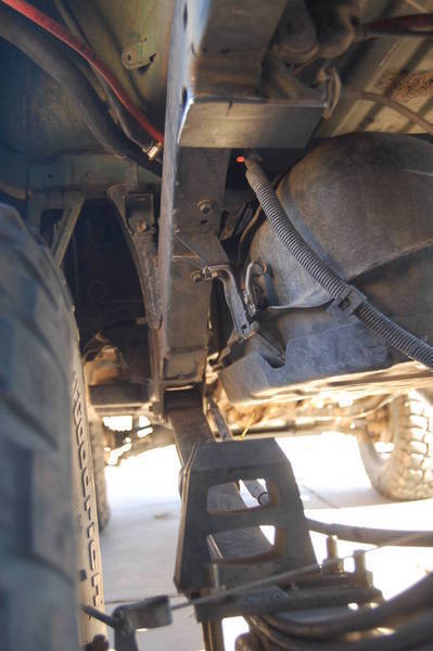

    alot of metal, small engine, decent travel.
    caged, camburg long travel, 50t leafpack (soon to be installed) light rack over cab, 5pt harnesses etc
    droop looks like a couple inches more!
    now question... you moved your bump stop closer to the tire, and moved the pad a little more inward. and while flexed your hitting the edge of the pad, what happens if the axle goes straight up and bumps? (not articulating, full bump on both sides)

    ^i don't know how that could even happen without him jumping his truck

    i guess im just used to the prerunning style. his springs are pretty soft though right? and ride height is pretty low, seems like it could happen with a little speed and a bump, or a couple woops?

    maybe! i mean my junk isn't nearly as soft as his and even with the bed weighed down quite a bit i've never came close to that.

    Yeah... got a few more inches. Won't get any more until the springs are broken in. Because of the very little uptravel on this set-up, and because the creeper joints tend to push the axle towards the stuffed side during articulation, the bumps are actually hitting very close to the pads in the same spot that you see in the picture during straight up-down travel.
    And yeah... even with putting the third leaf back in there, it's pretty soft. Albuquerque roads are absolutley terrible, and I know for a fact that I hit the bumpstops once or twice going over some asphalt "woops." :D lol :eek:
