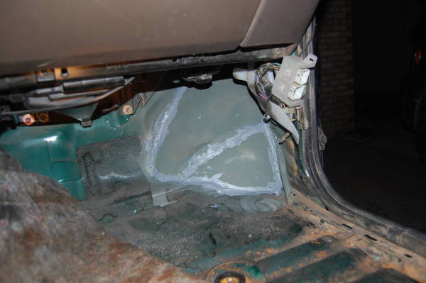

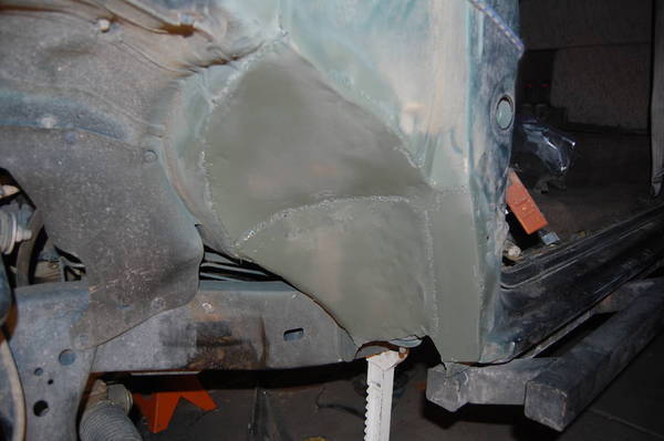

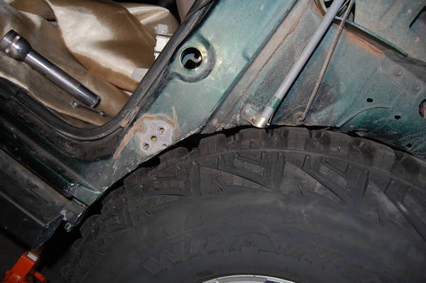

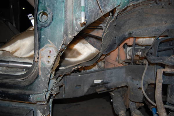

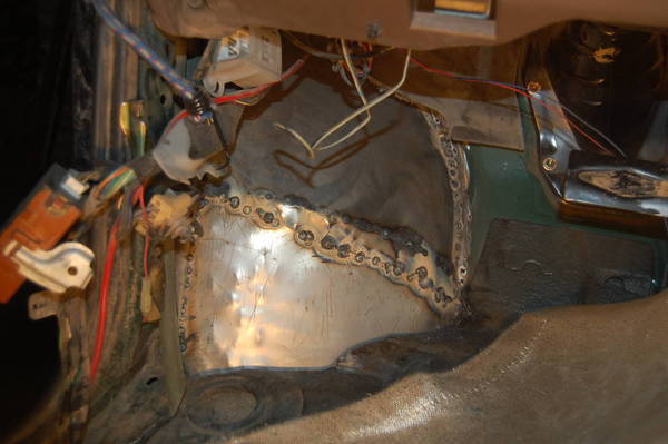

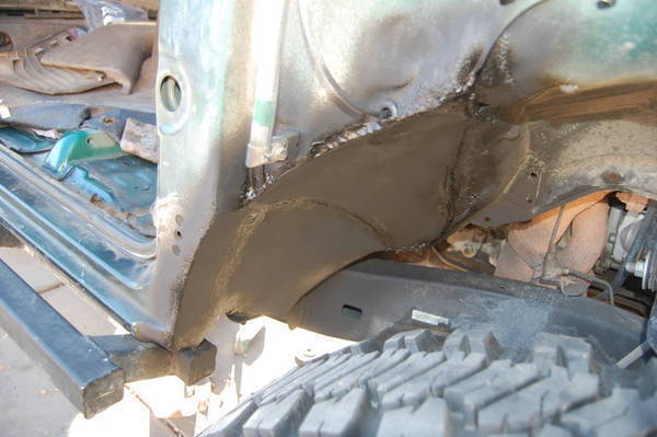

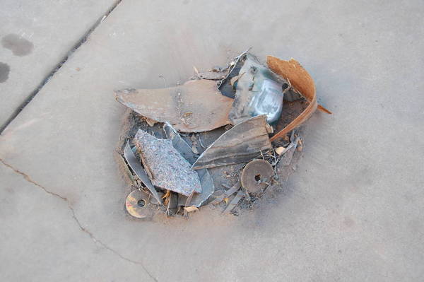

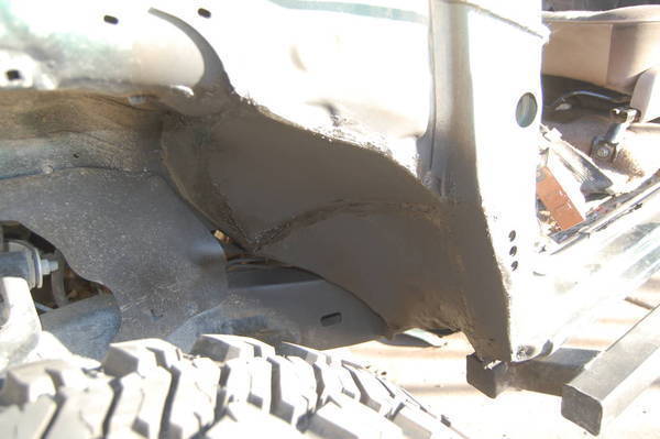

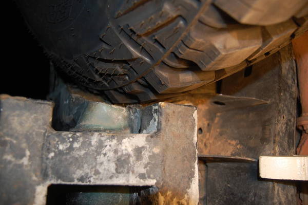

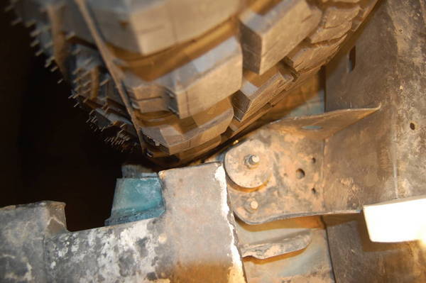

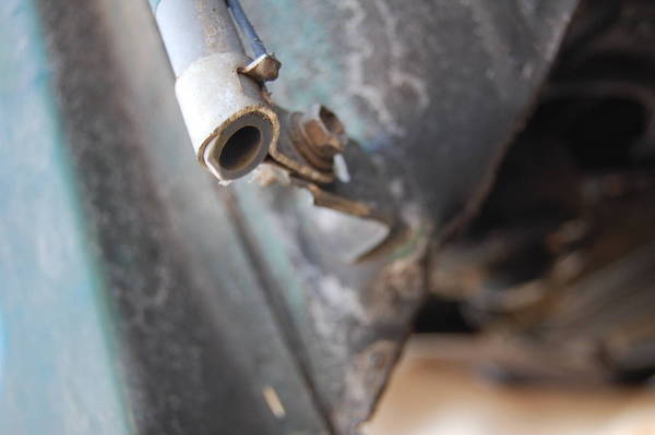

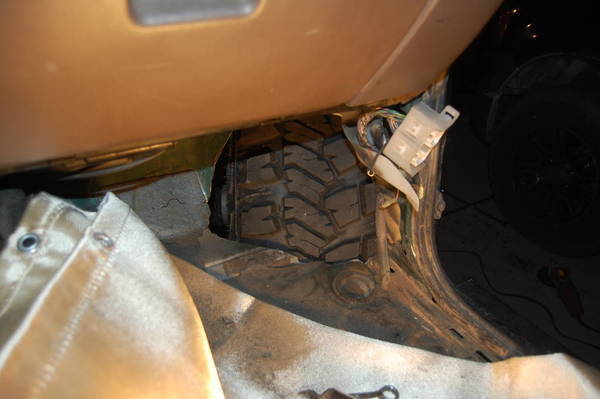

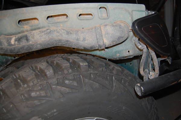

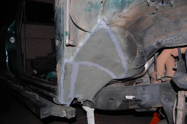

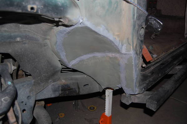

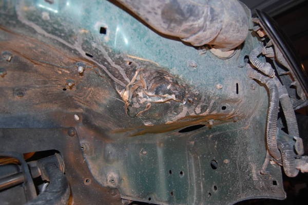

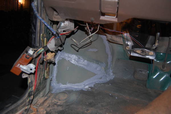

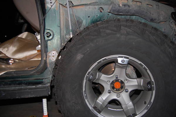

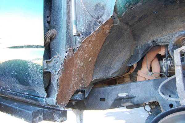

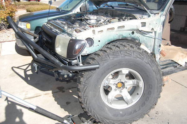

    Finally finished up tubbing for the 37s... Still rub the frame just a tad, but nowhere else!! :cool:
    Old POS tub job

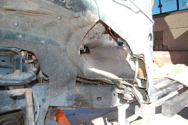

    Lot's of grinding.... full stuff
    other side..

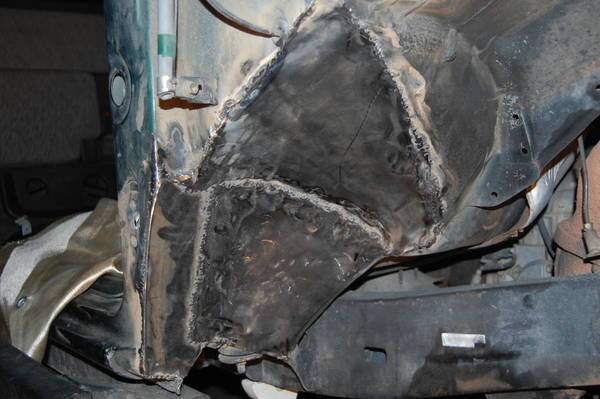

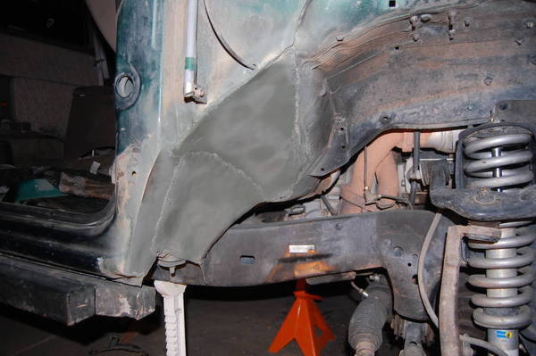

    Used 1/8" plate to rienforce the area by the edge of the cab (Jon's idea) and 22 gauge for the rest... Welded inside and out

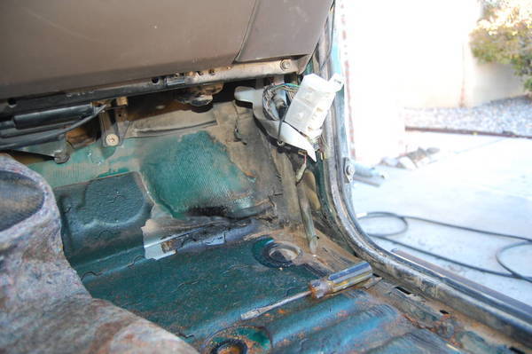

    Self etching primer
    Seam sealer from autozone..

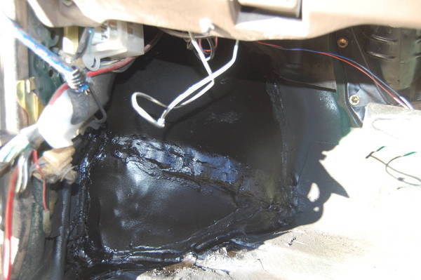

    rubberiszed undercoating
    Scraps
    Also, bedlinered the tailgate and re-located the license plate to the center. Pics later for that...

    Holy shit that's tight.

    Tub job looks a lot better! Great job!

    Thanks, man. A lot better than before...... that's for sure.

    Not much wiggle room in there anymore hahawow.

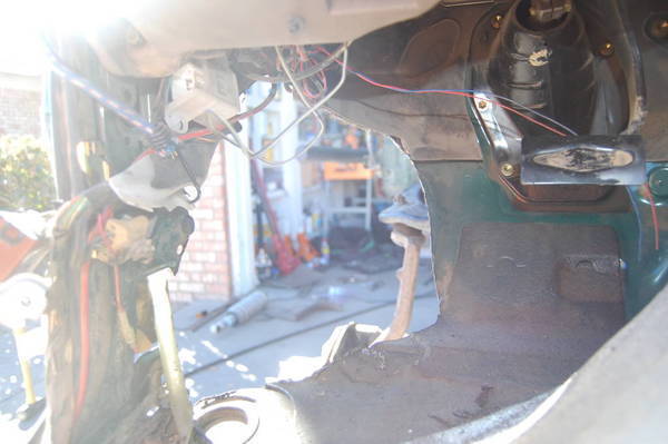

    shoulda left that gaping hole in the passenger floor, scare anyone who dares go for a ride.

    Looking good! You've got some balls :laugh:

    Tell me about it.. :eek:
    lol Or maybe put some see-through plexi glass there instead... :cool: That could've been pretty cool

    holy SWISS CHEESE
