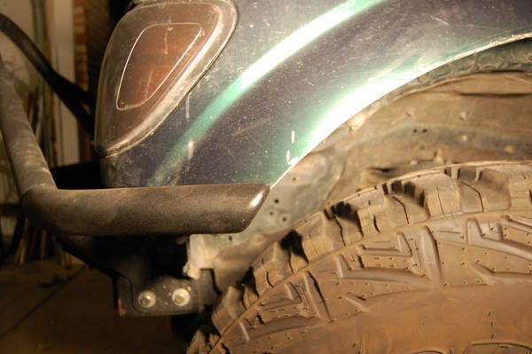

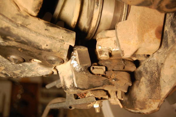

    Sooo how bout an actual build update!!! :D sorta...
    I mostly finished up my steering stops. Still have to fine tune with the grinder, and then paint.. I decided to make some steering stops for 2 main reasons: 1) my tires DO rub the frame at full lock. 2) both of my CV breakages on 37s have been when the wheel was turned all the way (which causes the outside joints to bind). I would have clearanced the frame if it weren't for the binding CVs..... this is simpler, easier and reversible anyway.
    Also, my tires rubbed the front bumper, so I cut the ends back to match the fender lines, capped and repainted.
