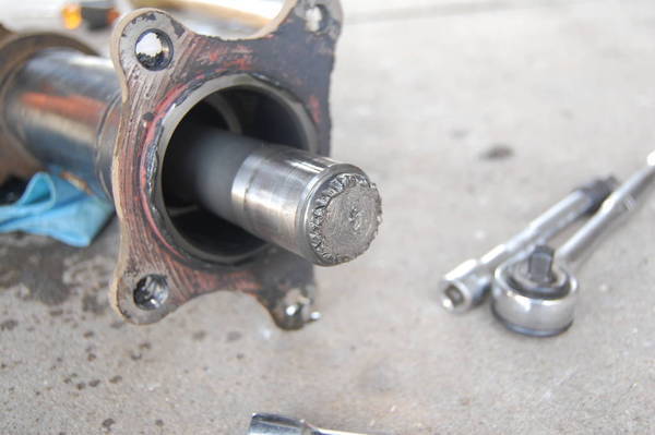

    Great idea! I'll give that a try, tonight. I actually had to go back to class right after pulling the diff tube, so I haven't done a thing since that picture of the broken jack shaft...

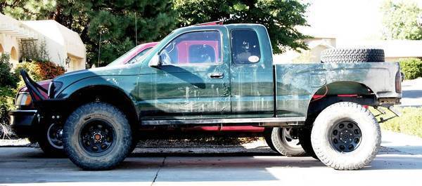

    look at how cute it was on 35s!!!!

    looks like a shopping cart :laugh:

    :laugh: So weird.... but yeah, they look so cute! :eek:

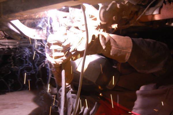

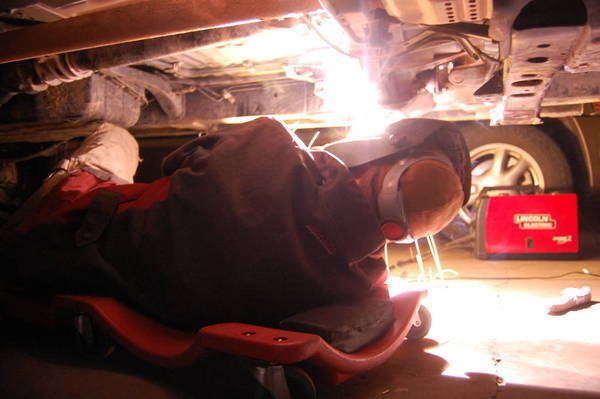

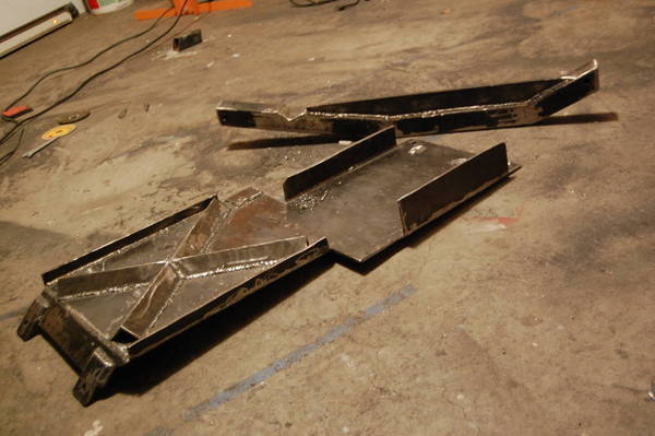

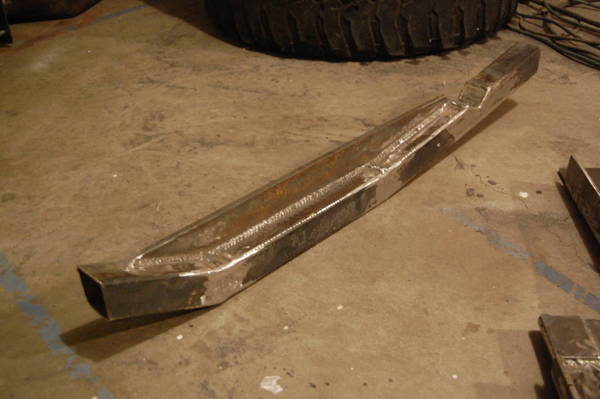

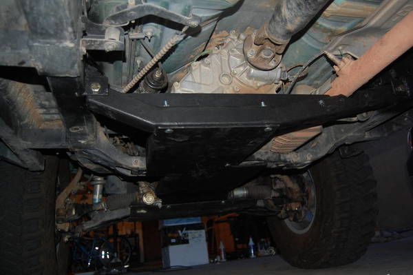

    Skid is 1/4" plate with 3/16" angle iron across tranny belly, whiskey bent with weave beads.
    X-member is 2" x .125" with a gigantor 3/8" "gusset" and a 1/4" fishplate.
    All mounts are 1/4" plate. X-member bolts are grade 8, 9/16".
    Bring on the rocks.

    Now ditch the IFS and your golden :D

    How the hell are you supposed to fit a crawl box in there now?:D
    I got to beat my skids up today:D 1/4" rocks!

    Heck yeah it does! :cool: No fear...... especially with the angle iron reinforcement on the belly! :D

    I have mine reinforced with angle iron too and I think I may have very minorly bent mine... I got a little high centered on a ledge so I bumped it a little and hit hard but to no avail and had to take the bypass. Well a little later we noticed a rattling noise from the engine and pinpointed it to my y-pipe which is now in contact with that skid and making the rattling noise. Doesn't appear bent but I can't imagine I broke the y-pipe since it is protected behind the skid and supported by rubber on the hangers. haha

    Nice, man, and dang!!! lol :eek: Just goes to show that it's not overkill....

    Nope. I really don't think it is overkill, although it really comes down to how you wheel. If they aren't going to see much then 3/16" or less might just be fine, but what you and I will throw at our rigs we need a little more. haha

    Damn man. I like the crossmembers and bracing.
    However I'm going 1" UHMW I think...hopefully be lighter.

    I don't think it is any lighter from what I have read (haven't confirmed though). Will be slicker though!:D

    How are you bracing it? The UHMW will flex if hit hard enough and not braced.

    Thanks, bro!
    UHMW will be sweet!!!!!!! So many benefits over steel or aluminum.
