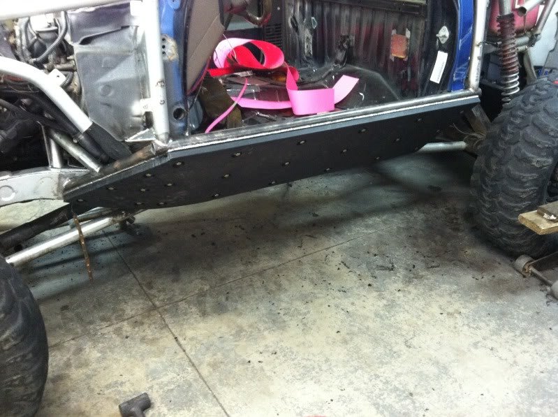

    Crossmembers.
    One rear one. Then the stock middle one. Then I'm making one that'll bolt up to the old sway bar mounts. :cool:
    Plus beams running from the front and rear crossmembers to the center on on the outer edge.
    I think it'll be fine :D

    Boat sides??
    And yes! No rusting!! :yay:

    Yeah I've been looking into making some skids out of it I've read it flexes if not braced with steel. So maybe a frame of angle iron at the least to limit the flexing.

    Basically what I was gonna do. Think ill use 1" square. Then rotate it like how sliders are so the point edge is down. Then cut out Vs in the UHMW for it to sit in perfect. Not super deep ones but just to keep them from moving other then just bolts.

    Yeah that should be good :cool:

    Yea....I'm excited :D
    Should be under 200 for a full belly skid :cool:

    I was mostly joking. :p
    That's rock crawler status, homie..

    could fill in my sliders with it lol
    jk
    no thanks..
    im just buying a 24x48'' sheet and its all going under the truck.
